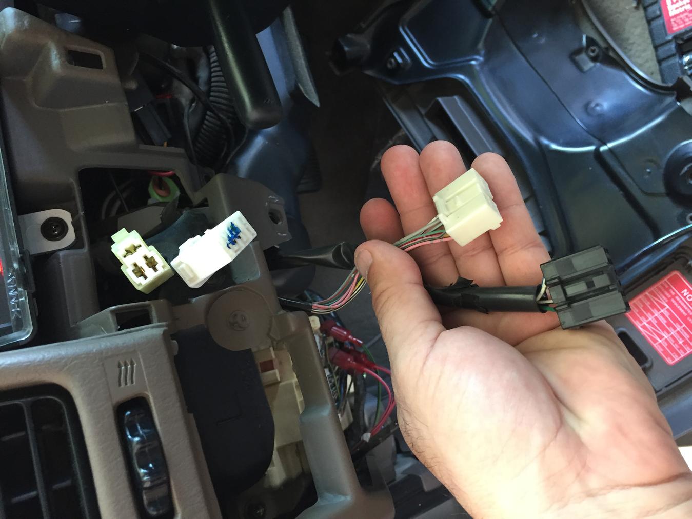

Was doing this LED conversion and now after putting everything back together I'm left with these two plugs in my hand. The top two are for the dimmer and the center diff lock. Anyone have any clues? Mine is a 2001 4Runner with 4x4, SR5

Thank you!
