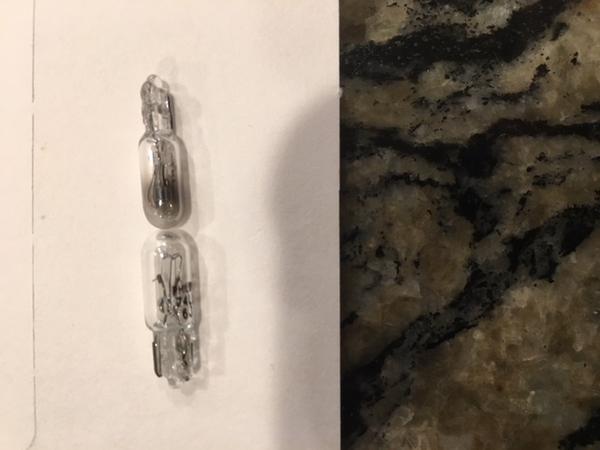

Something ain't right. I bought #74 bulbs for the ash tray and glove box for my 2000 LE and the bulb portion of the bulb is too fat for the bulb to seat into the holder. No workie. The base looks right but the bulb is too large. Is there a slimmer bulb out there with the same base size?

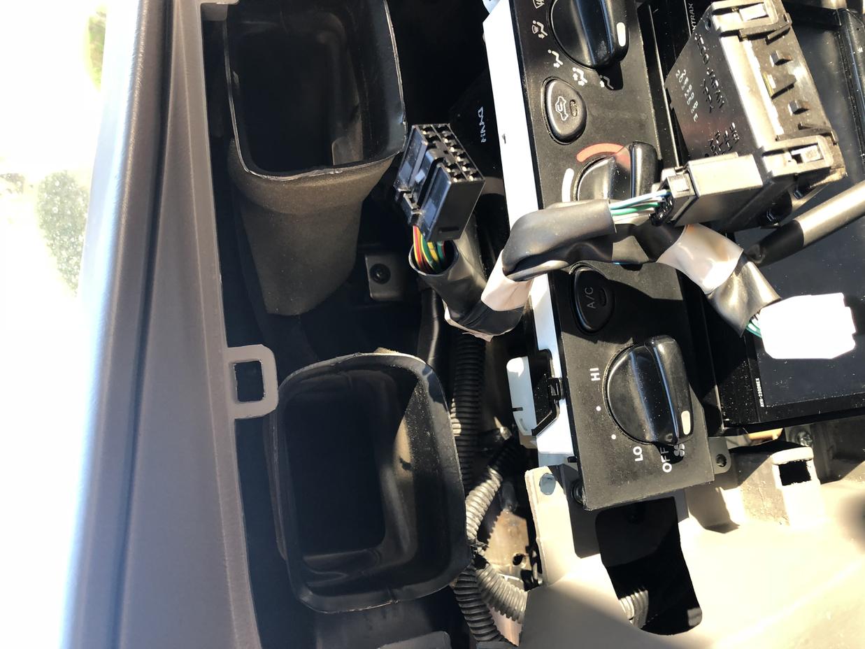

the two right knobs on the climate control were previously burned out, and I was unable to get any of them to light up when testing them out, switching both sides to check for polarity. I used the Neo-wedge B 3 and 4 mm respectively.

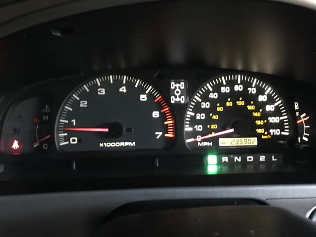

Added LEDs from superbrightleds.com came out great other than the left side of the cluster. Anyone have an idea of what the cause would be?

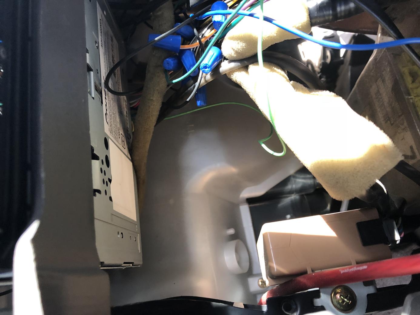

So background, all instrument cluster and taillights are out, but the brake lights work. I replaced all instrument lights and they were working at one point. I tried to tap into the dimmer switch light to add an interior accent light, like RipCord's, but cut the green wire. After my cluster not working anymore, I abandoned that idea and reattached the green wire, as in the picture and the TAIL fuse still keeps blowing.

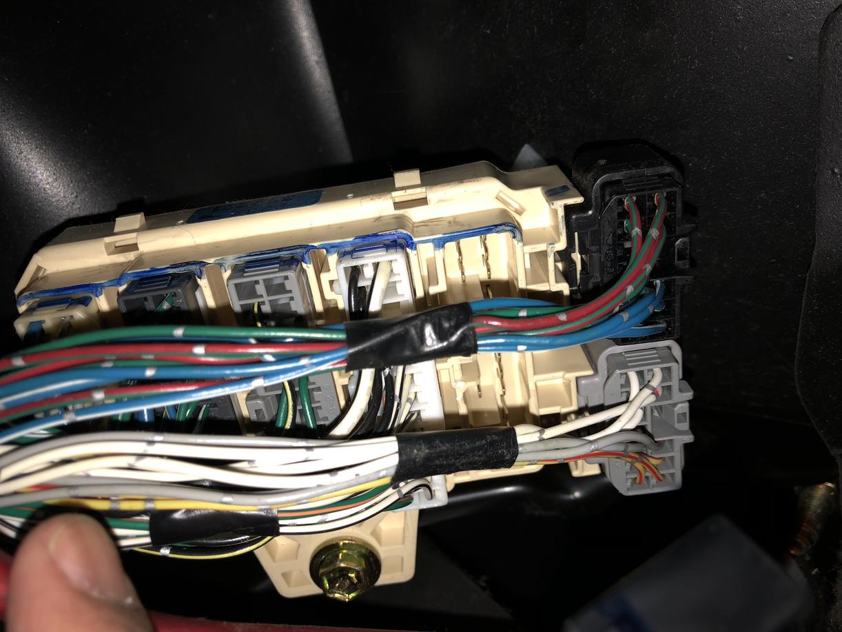

Thanks for the help! I can't seem to find the center junction box...am I looking in the wrong place?

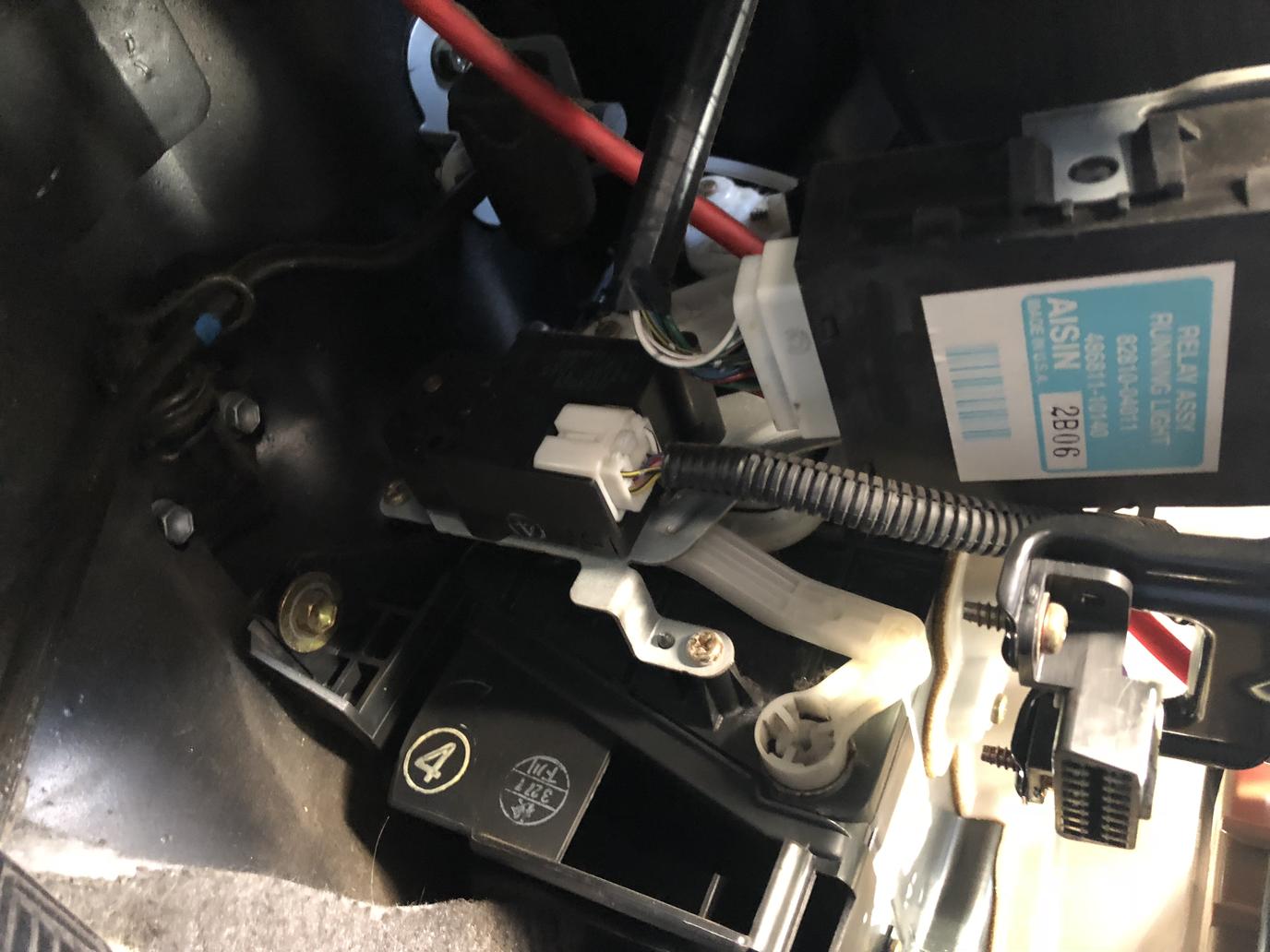

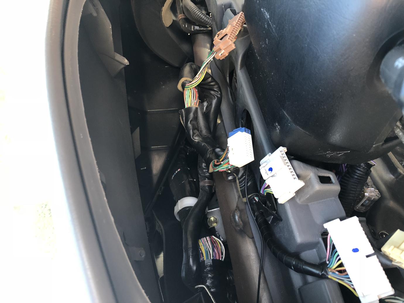

Looks like I found it, underneath the steering wheel near the brake pedal. I unplugged it but now the headlights don't come on at all also. Do I need to replug in everything on the gauge cluster? What do I need to reattach? I don't want to put the whole thing back together just yet if I don't have to :) IMG_0602.jpg

Yes. Everything. You should not need to pull the cluster at all to get to the center j/b.
