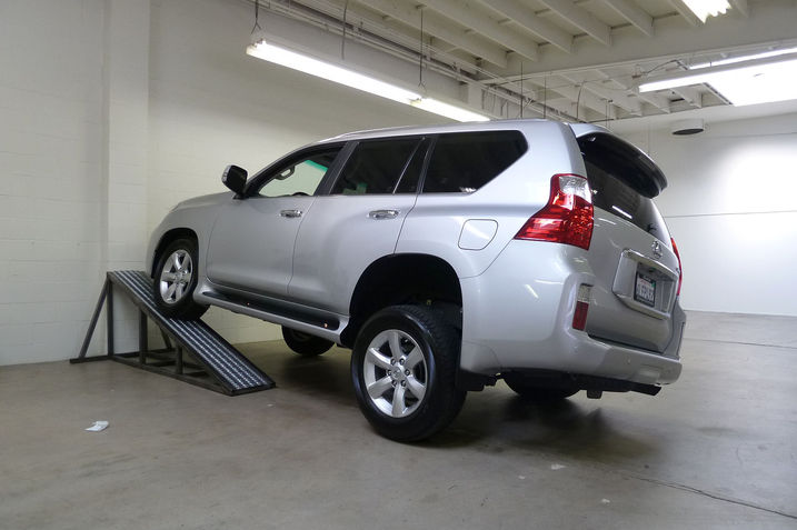

So Koz are you saying that if sway bars are connected (on 5th Gen 4Runners)that will be the physical limiting component (the sway bar) and will be the component that stops the wheel from travelling upwards or downwards thereby determining maximum articulation? This is what you alluded to in your post and Thai too.
Yes! If the RTI score is better with KDSS then without how could the bump stop be the limiting factor? Why would anyone go through the trouble of disconnecting sway bars?
If you do not plan on modding the suspension KDSS is the best system/design available from Toyota. It provides the best of both worlds (on/off road). Maximum articulation off-road and almost no lean/plowing on road. Then when you combine this with air-springs and adaptive shocks (like on the GX460), it makes for an incredibly controlled ride. I tow a travel trailer with no sway/WD devices added and it is amazing. I just got back from an off-road trip and can tell you, this set-up works extremely well. Noticeably better then the XREAS/non KDSS system. The biggest difference was on the washboard roads at speed. I was running 35+ mph like it was a walk in the park. I was able to hold my video phone (POS SG3 lol) with one hand and buzz the washboard road with the other!

Does KDSS actually allow the sway bar to move freely under articulation? If so, then i would say it increases travel. No it does not EXTEND travel any. It allows the bumpstops to be the compression limit rather than the sway bar and the coil springs.

Sorry, KDSS is good off-road and provides better real-time articulation. IT IS PROVEN WORLDWIDE. RTI shows this. Since we have so many SR5 off-roaders, we won't have a problem measuring wheel travel stroke distance. Insideline measured it.

Are you saying a TE with kdss has more travel than an SR5? They're both the same trucks, take the sway bar off the SR5 and it will climb higher up the ramp.

So in summary - both non-KDSS and KDSS articulate and travel the same, but the KDSS equipped vehicle may have a little more freedom (ie, only battling the force of the spring VS the force of the spring+swaybar in non-KDSS vehicles)

Actually, my understanding of it is quite accurate. It is harper and you that need to read up more on KDSS. (I do so much like it when harper look down on Prius owners...only later having to eat his words! :D ) Yes, on fire road, the KDSS 4runner will be better. KDSS improves articulation...it may not extend wheel travel in the absolute sense, but when off-roading, the improved articulation (flexibility of the axles) are noticeable. I saw it with my own eyes with GX470 KDSS vs. FJC when off-roading.
