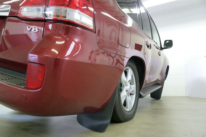

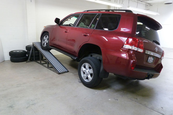

How about this for KDSS articulation, on a STOCK vehicle with a 112.2" wheelbase;
24.81" of travel and a 647 RTI score!
Notice the limiting factor (mud flap) on the other side!

How would you explain the same vehicle (GX470) with KDSS scoring a 519 RTI and without KDSS scoring a 428 RTI?

RTI ramps only give you a sample of what a vehicle can do off road. It doesn't replicate the forces of different terrains mixed in with body roll, suspension flex, etc. The reasoning behind the different scores is due to the KDSS allowing the sway bar to go loose which reduces the force on the sway bar thus increasing the RTI score. RTI ramps are great and all but the real world will show that a SR5, TE or Limited will have the same flex with or without KDSS.

Sorry, an RTI score measures the amount of articulation a vehicle has in a controlled test. There is a simple reason why the KDSS equipped vehicle has more articulation, the sway bar is not being the limiting factor. This has NOTHING to do with replicating forces or different terrains. Both vehicles are exactly the same except for the sway bars and each vehicle is measured the EXACT same way.
