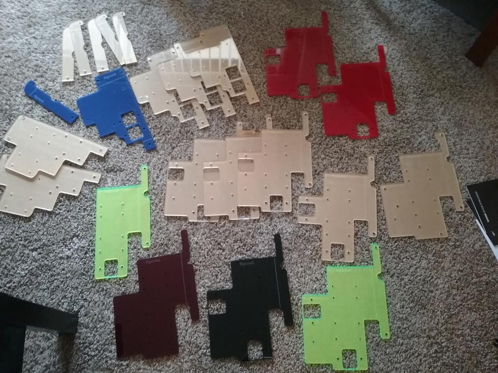

For everyone who was not able to get the platforms while they were available, I am still selling the PLANS for them. In adobe illustrator format. You can get some acrylic yourself and find a shop with a laser cutter to cut it for you. Easy to find in most big cities.
Plans are $15. Send me PM with the same format.
I have cut a little more than half of the current orders. Everything will start shipping out next week.
FOR ANYONE WHO ORDERED WITH LOCAL PICKUP, YOUR ORDER IS READY. I will get in touch next week.

All orders are cut and most have been shipped.
