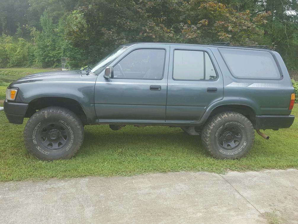

You're right, there's definitely not a BJ spacer I figure after looking through their products and inspecting my front end. Concluding it's just cranked torsion bars, as you said. Thinking I might wind em back down to smooth up the ride after I replace the front shocks. As I go through all various bushings and whatnot, I may add some spacers to the front, but I don't see much need for me to run anything beyond a 31/32 inch tire for my application
You should wind them back down. Judging by your picture they are cranked to the max. Here is my How To Thread on adjusting the bars to stock using the factory service manual. It has service manual pics, and the exact numbers you need:

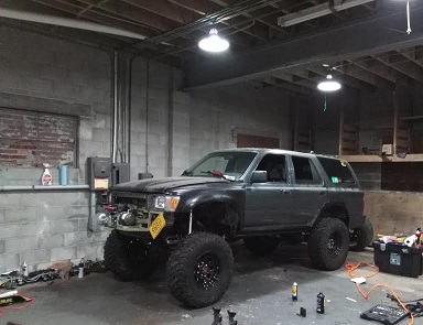

Just wanted to let everyone know that i scrapped the frankenstein lift idea and installed a pro comp stage ll - 4" lift. Heres pics before and after. Im super stoked. Now comes the time to clean it up a bit, she aint pretty on the eyes lol

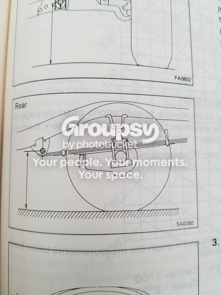

Here is how you measure it as per the factory service manual:
Measure at the center of the front mounting bolt for the leaf spring on an extremely level surface, like a leveled garage floor:

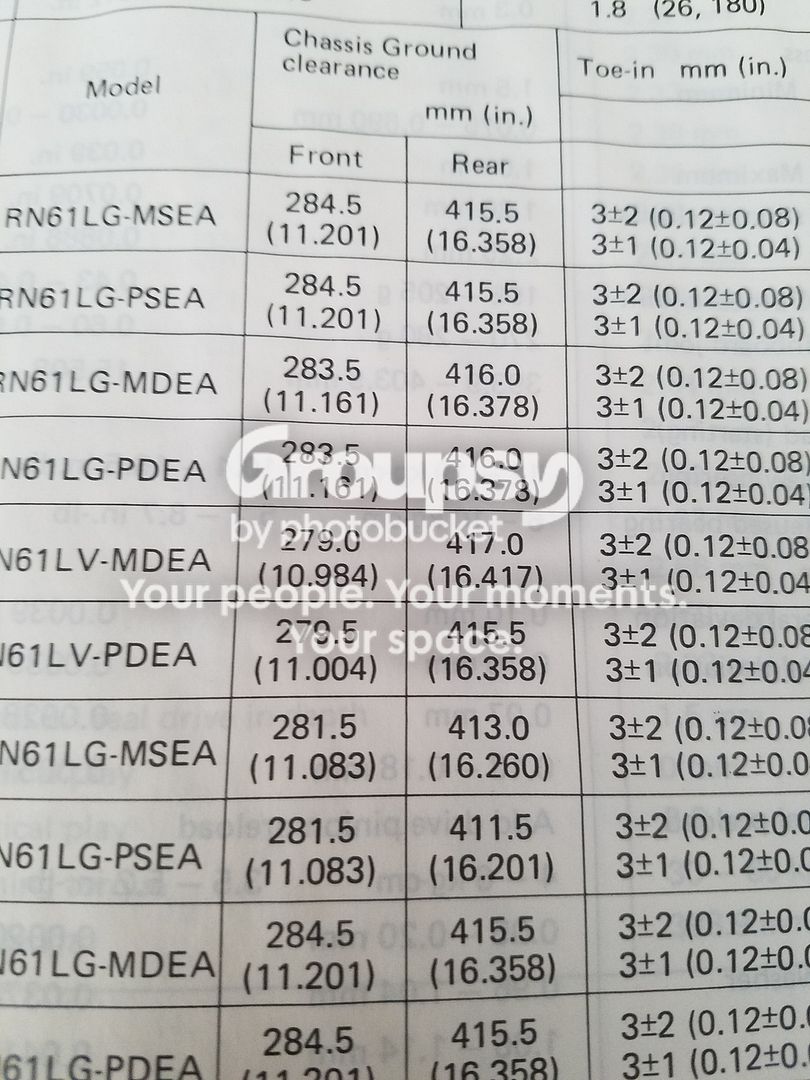

***The height should measure 16.3" on NEW 225/75 R15 tires inflated to 29 PSI. For NEW 31x10.5 tires add 1.35", so 17.65".***
20160624_155041.jpg~original
I have found the front to be stock (using the FSM method of measuring at the lower control arm front mounting bolts, 11.2" on 225/5 tires, 12.55 on 31x10.5 tires) to equal 13.5" measured from top of 15" stock wheel to bottom of fender lip directly above it. That SHOULD mean the rear at stock height should measure 11.5" as the rear fenders are two inches lower on the back of the body. This should be the same no matter what tire size. Make sure the front is right before you attempt to restore the rear.
Front tire pressure for either size factory tire should be 26psi, these trucks are quite light. (Ensure your front tires are not at 35 PSI or something, and people wonder why they IFS seems so rough in stock form, hahahahaha). Rear should be 29 PSI (sometimes door sticker says 35, but the numbers I gave you say 29psi on that FSM page).

Why on earth did I not think about going to the FSM?
:high5:
I have 225 75R16 tires so if my tire calculator is right 1" larger diameter tire.
I get 12.2" in the front, so ~0.5" high over stock (11.7" should be the stock front height with these tires). Probably ok as the air pressure is 34psi.
I get 16.1" in the rear, so ~3/4" too low (16.9" should be the stock height with these tires. I'm guessing a full inch too low as the tires are inflated to 34 psi.

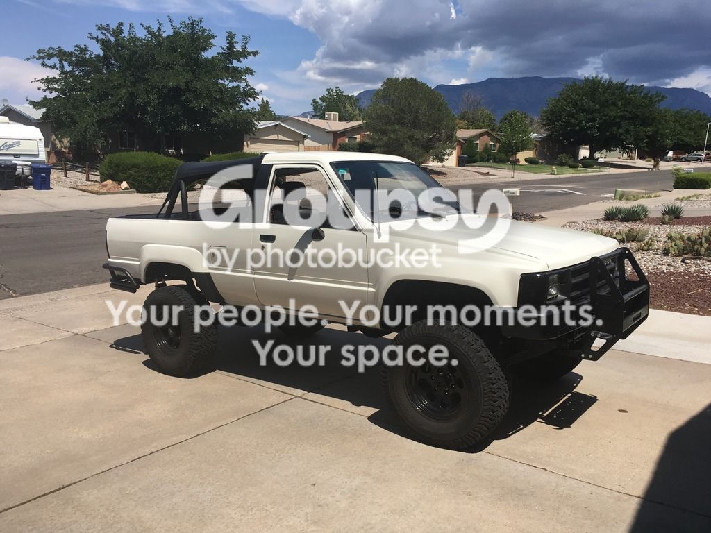

4" RC Rear lift, 3" TG IFS Eliminator Front (Just installed, springs still really need to settle), with 315/75/16 (35's). Will post more as the springs settle and when I go larger on tires. Forgot to mention its trimmed 2" rear and 3.5-4" front
