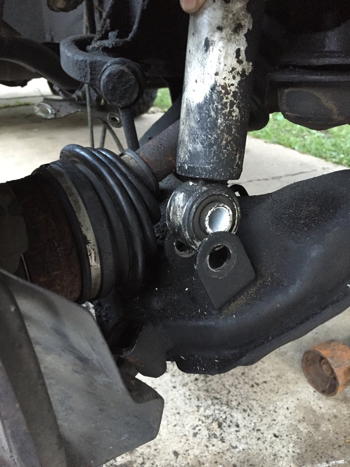

Looking for best bang for the buck extended travel shocks for a 1993. Putting spacers in and the shocks don't have enough travel now.

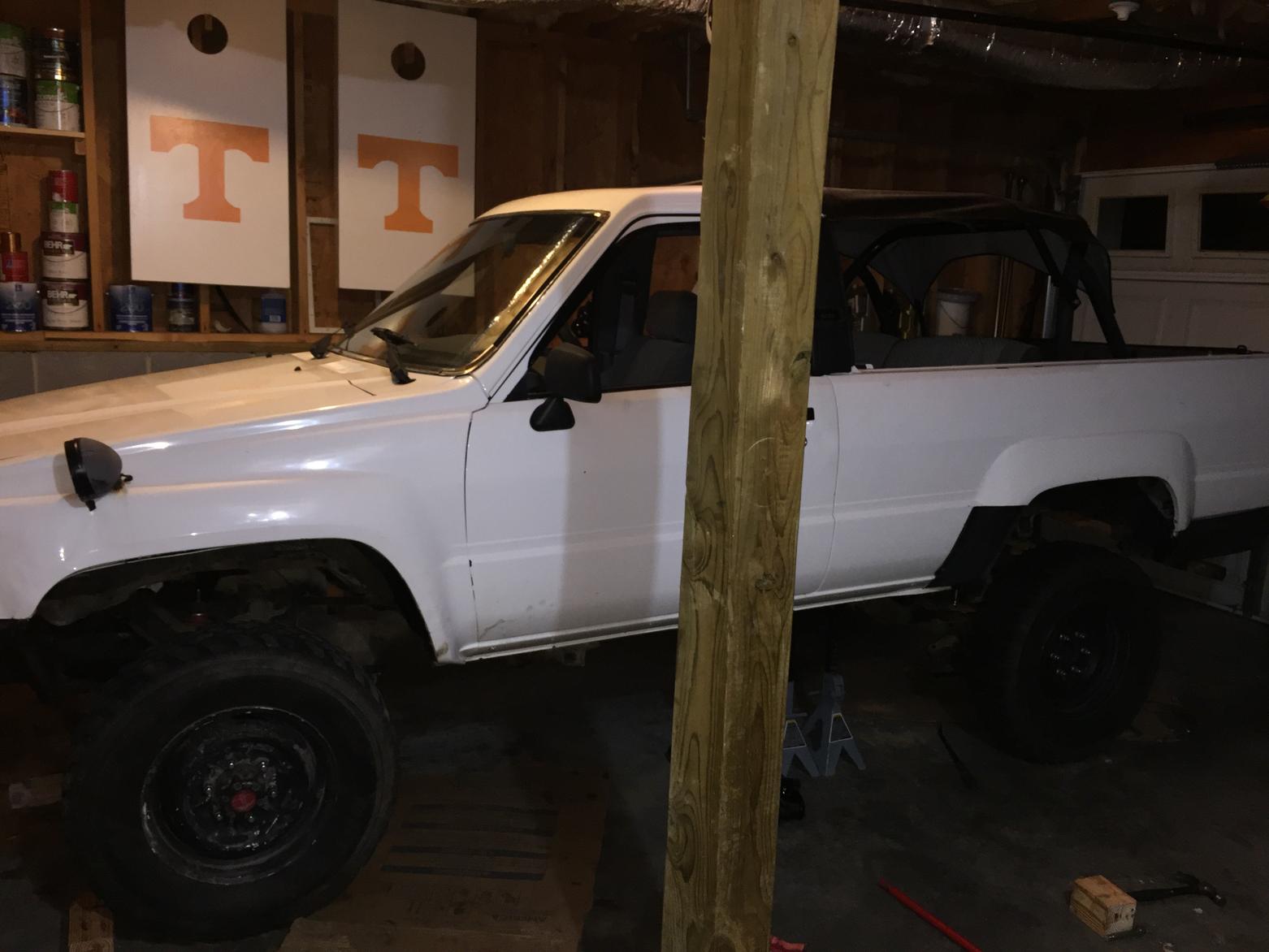

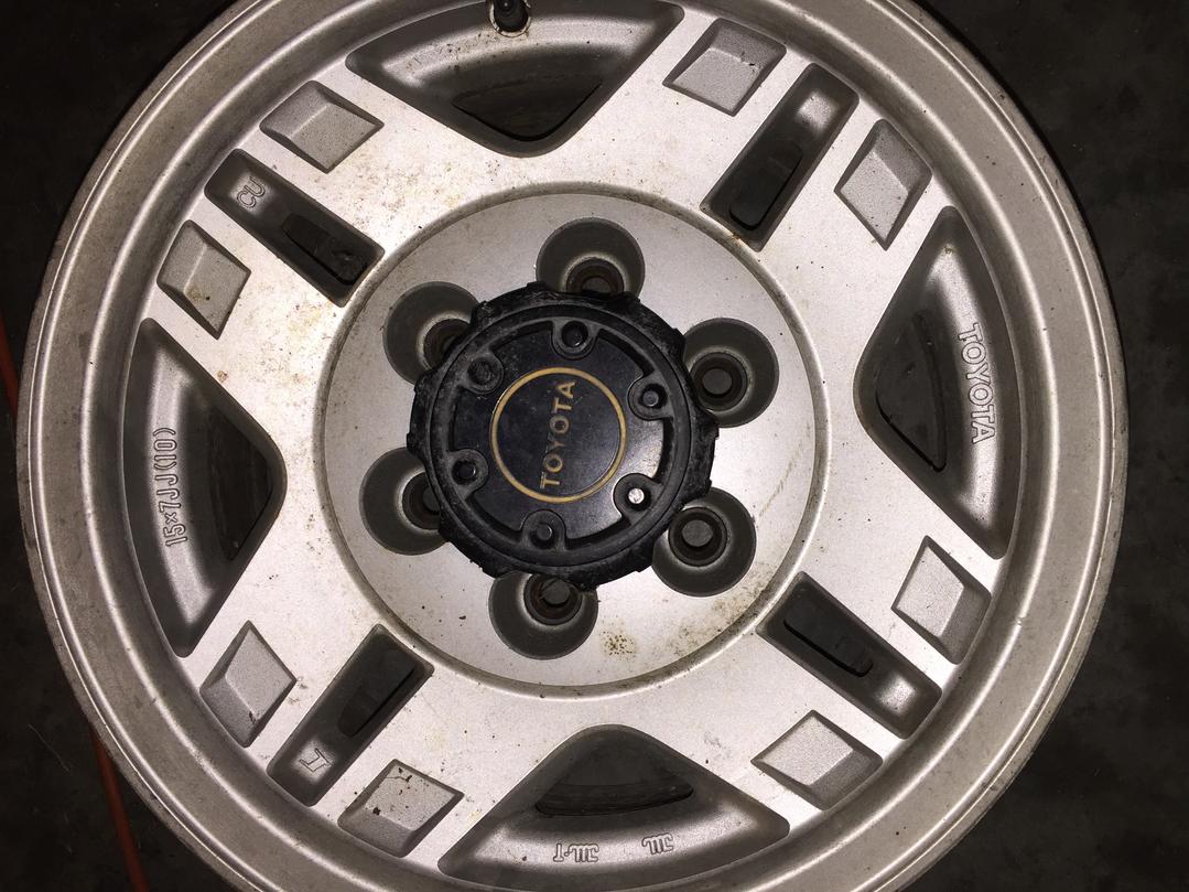

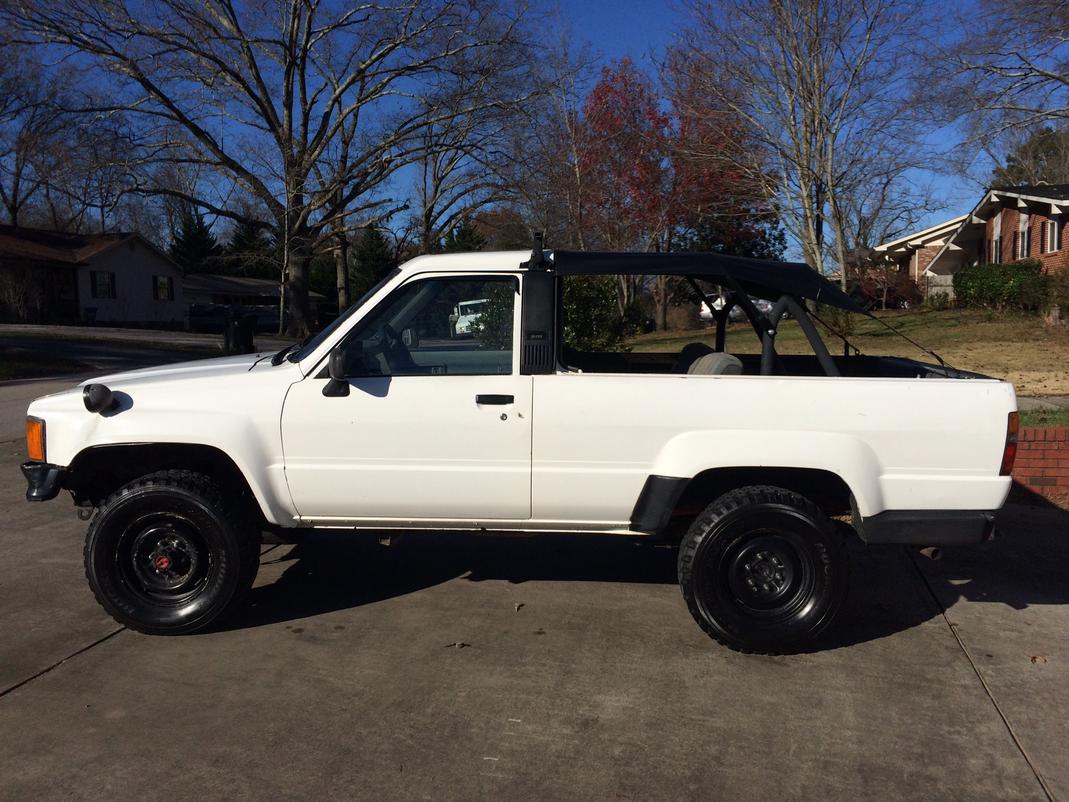

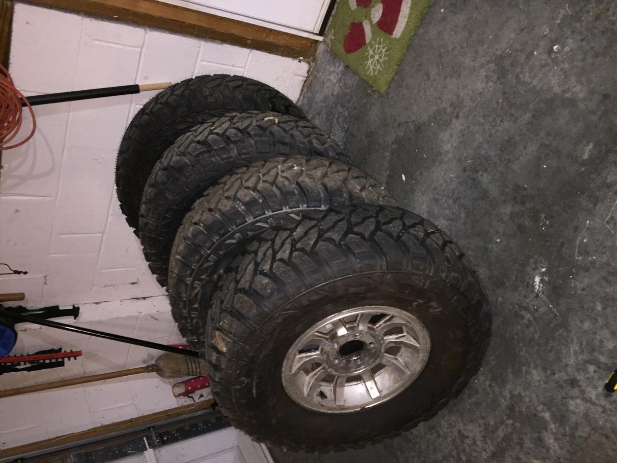

Going with BJ spacers and add a leaf for now. Bj spacers went in great, fighting with leaf springs most of the day. Hopefully finishing the leaf springs tomorrow and then headed to alignment shop then new meats getting mounted on wheels.i have stock mid 90s t100 wheels. 15x7jj will these fit without rubbing? They seem way deeper than my current steelys.

Here is mine... 100% stock with 33x10.50x15 BF Goodrich Mud Terrain KM2's... NO RUBBING, even at full lock!
This is amazing. Glad to see I can stuff 33s prior to lifting, but planning piecing together the lift through the winter and jumping to 33s post install, late spring maybe.

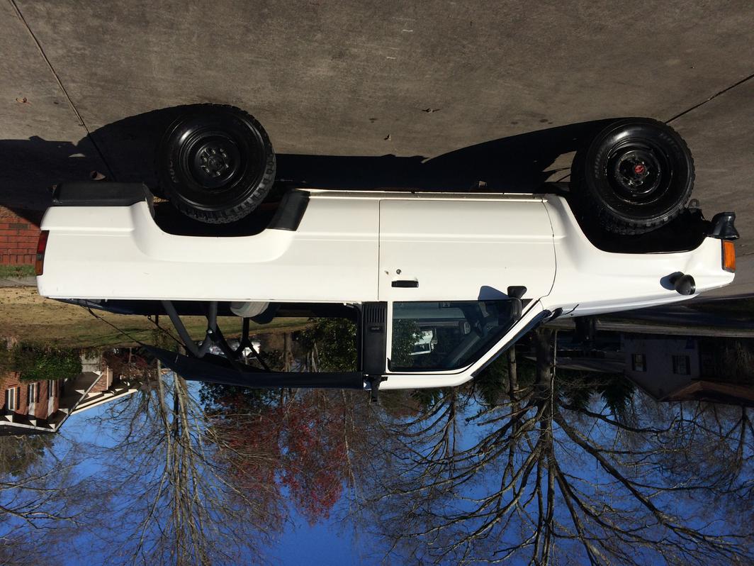

Finally

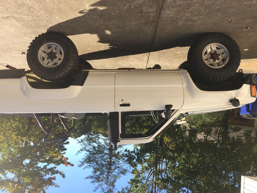

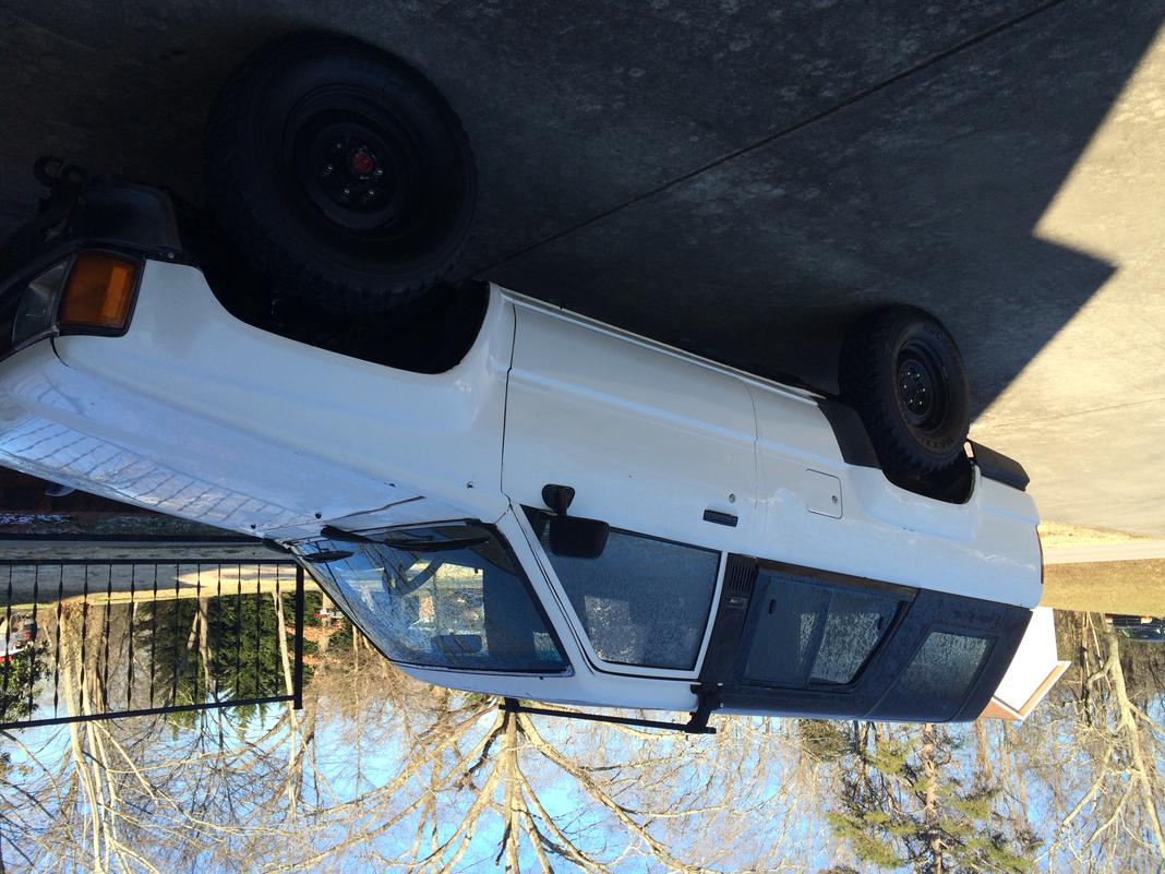

Finished up today. Took to alignment shop and got tires and wheels put on. They said my castor was too far off to correct due to frame being beat to hell from abuse in woods. I'll be replacing my pitman arm and taking back. Still looks good though!! Before and after.
OME kit with 3/4" BJ spacers in the front. Need torsion bars adjustment but that will be after the ARB bumper/Warn winch installed. 31" tires for now until I can save up for the BFG 33's.

Like the pics, whats the bolt pattern on 1st gens? Which other Gens will fit first gens. I will be looking for new rims.
6 lug 6x139.7 in metric or 6x5.5". Make sure the wheels have the center hub bore of 4 1/4" to clear your locking hubs. Otherwise, you'd have to run spacers.

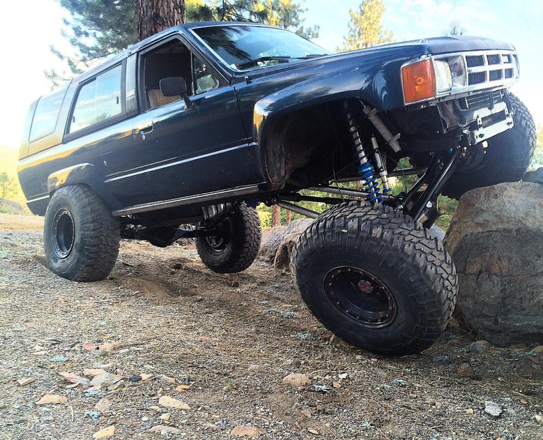

39.5x13.50-15R. 3 Link. aluminum links. 14in king coilovers 150 over 250. 4in TG leafs

So scratch that looks like you can use samurai spec shocks for the front with a 1.5" BJ lift? So for a LC/BJ lift you need
LC coils, panhard drop bracket, Rear shocks, (looking at stock LC rock auto)
BJ spacers 1.5", diff drop, front shocks? (Looking at stock 91 samurai front shocks rock auto)
What do you guys think?
