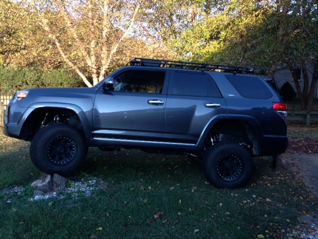

Based on my measurements to make it level they need to come down somewhere between 1" and 1.5" to make it even with rear height.
I also plan on calling Icon just to see if they have anything to add. At this point it should be a straightforward fix--- just crank the coilover threaded ring and realign.
I'm trying to upload a pic showing just how tall the front really is--- that front wheel is technically under compression but it's still tall as hell!
Here's the pic.
