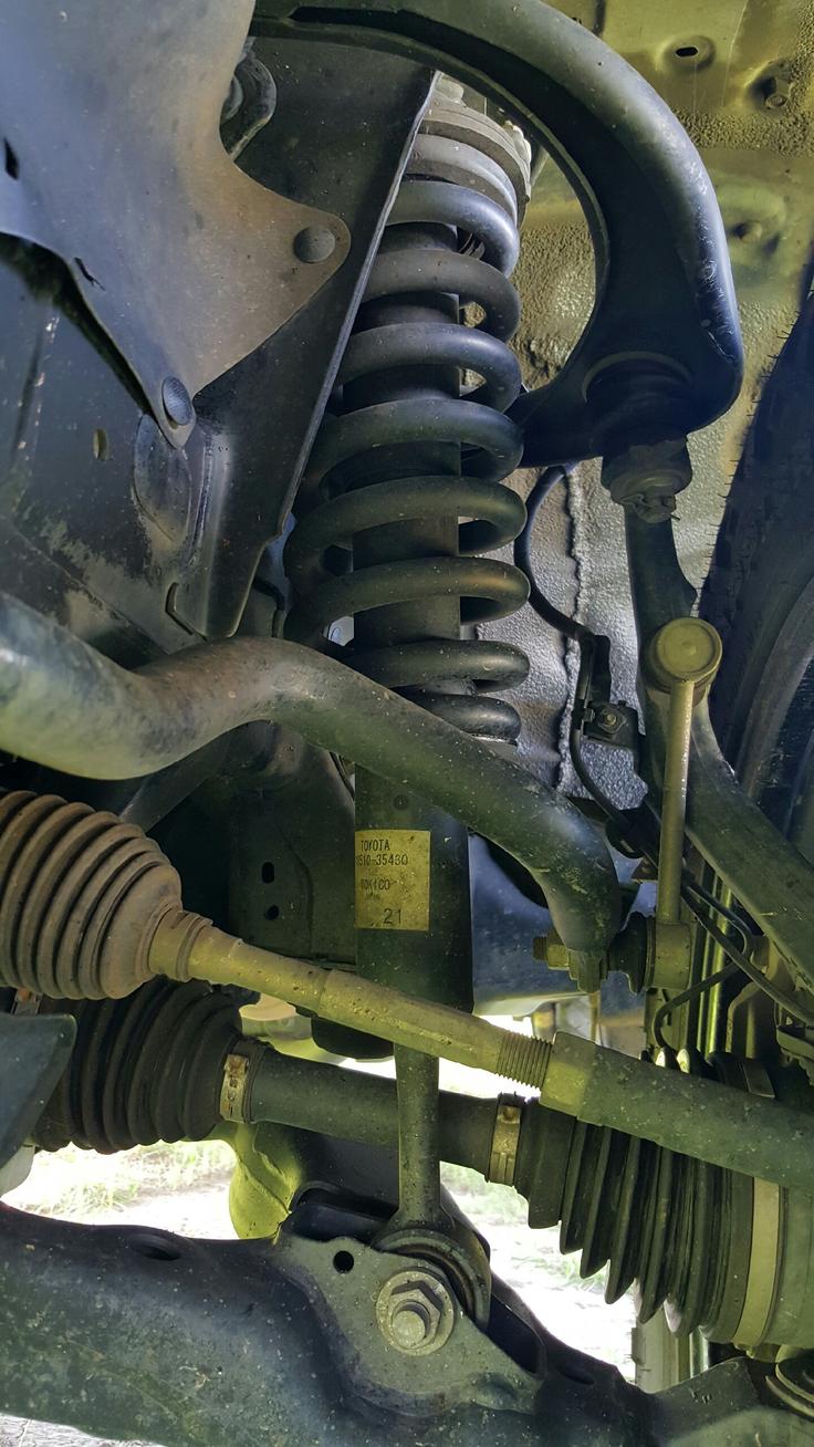

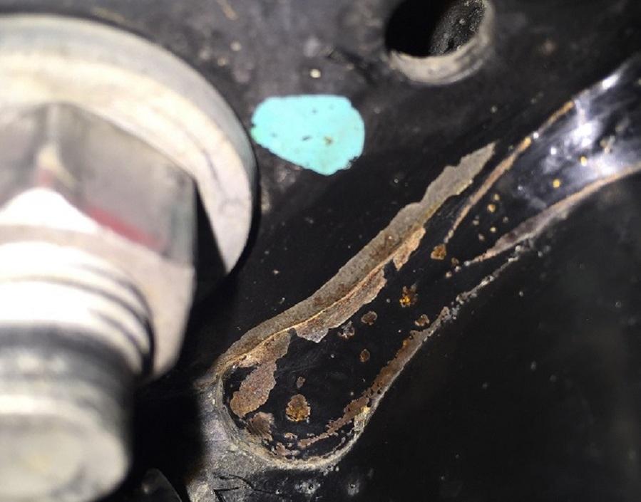

I noticed cracks on both lower shock mount flange weld. Toyota of course is pointing at the shiny new coil overs and saying... "No". Paint definitely cracked and came away with thumb nail, with no visible fissures at the weld joint. Slight rust build up where the gap was in paint tells me its over a week old.
Anyone with or without lifts seen this before? Thoughts?

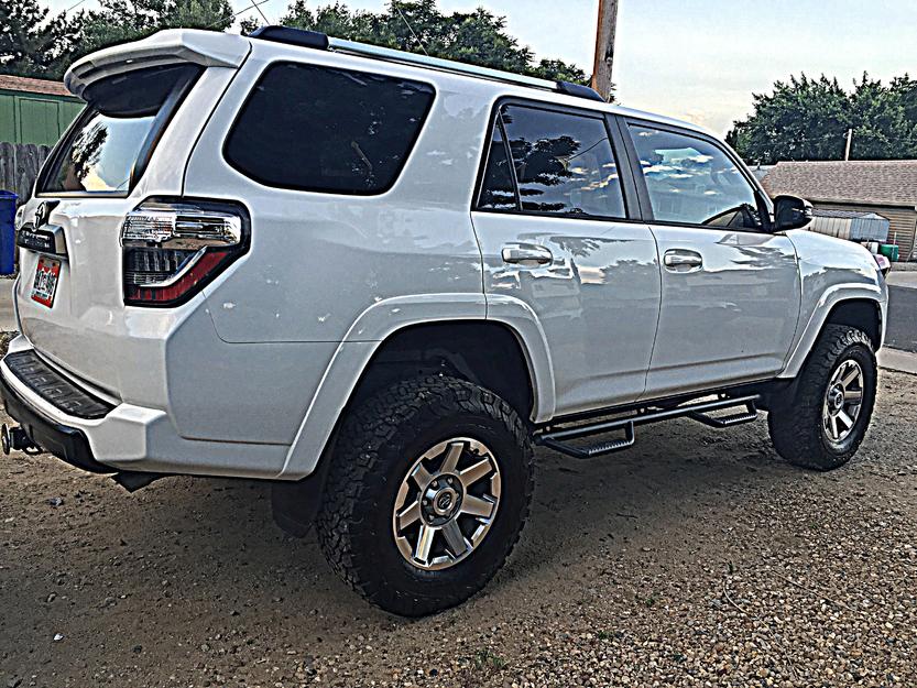

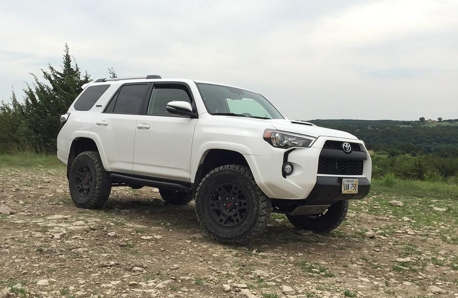

Poser-proud shot of new look from this weekend at Tuttle Creek ORV, Kansas. Working on external Photo site so bear with me...
Which front lift did you install? Did you disconnect the upper control arm and slide the assembly in and out that way instead of disconnecting the lower control arm?
Bilstein 5100 @ 2.5". I left the UCA alone and just disconnected the lower ball joint assembly with the LCA supported by the floor jack. Lowered the jack very carefully as to avoid a trip to the hospital. The spring and strut fit through the UCA no problem once you unbolt them.

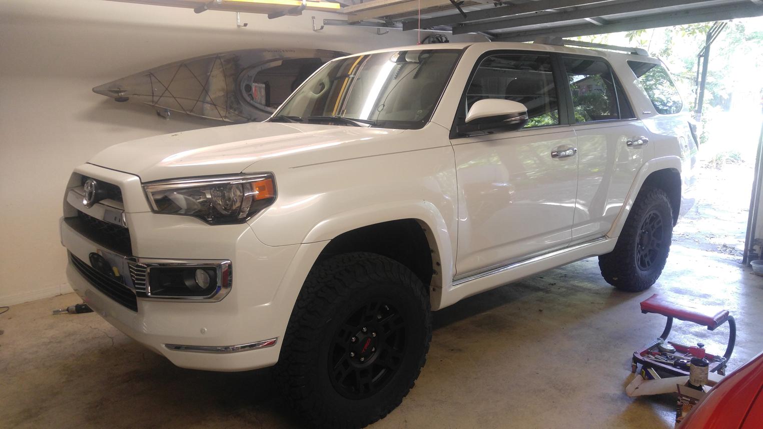

At 30K finally have got a lift installed 4- 4Runners later! :clap2:
Decided to go with 285/70/17 KO2's and could not be happier! Someone mentioned using a heat gun for the inner fender walls- this worked perfect! I had very minimal rub after the spacer install.
The only thing I have noticed is that I have to down-shift on hills so that the transmission will kick into 5th gear otherwise it hangs at 3K RPM until I do. Anyone else notice this?
