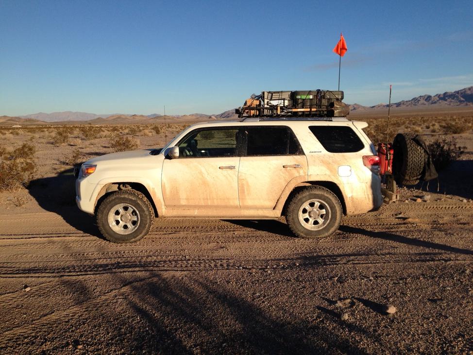

Here is a picture showing loaded 4 Runner on Stock suspension. Serious sagging, departure angle significantly impacted. This is why I put OME lift in with heavy duty springs.
What weight do you think you had loaded on top? I was thinking the weight I would have is around 250-300lbs. Thanks for the pic's and info, greatly appreciated.
It was some camping gear and firewood, so about 100 pounds on top. The tire gate and spare on the back are about another 150 pounds, so it was loaded up. Still, the stock suspension will sag if you have fuel, RTT and camping gear. Airbags are one option, but from what I see most people avoid them for off-road use. If they tear they're done for.
Ya, that's what I was afraid of; them tearing. The trails are supposed to be long and rough over the 5 days. hmm..bite the bullet and get the OME I was thinking about getting might be the path. Got some thinking to do. Thanks again.
