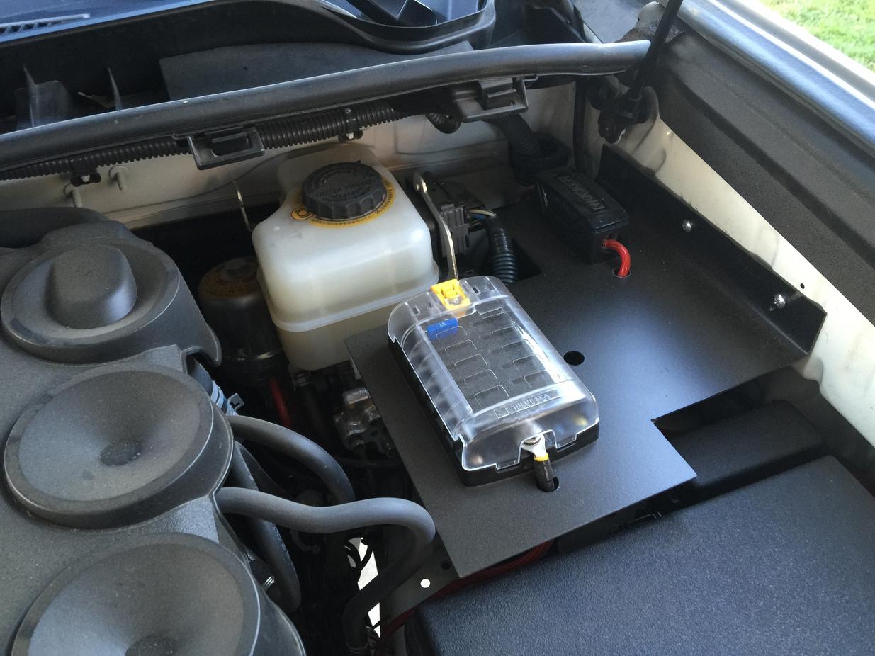

Here is mine. Working on production w/ powder coat and all.

I bought the Blue Sea Systems 6 fuse block with negative. No complaints as of yet. I also added a battery isolator just for fun.
