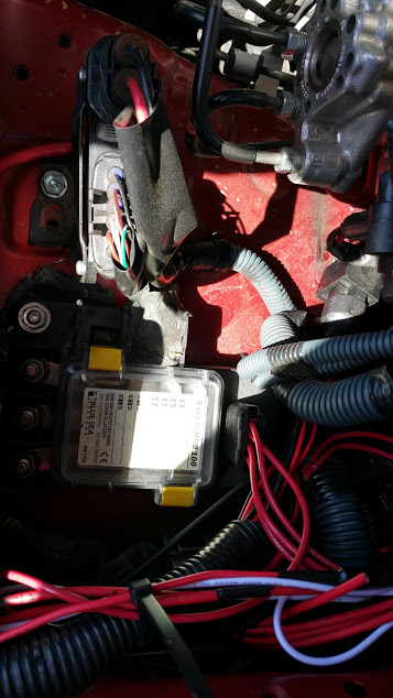

I'm using this for my power distribution.
Safety Hub 100
