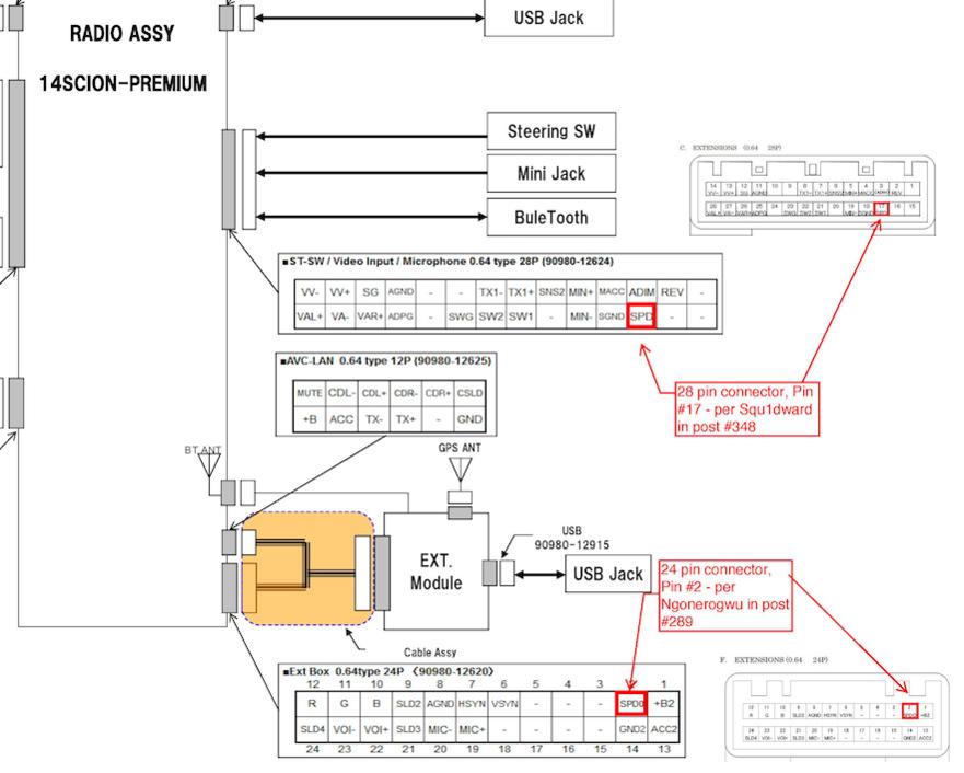

I still have a few questions with the navigation. The issue I am having since installing the navigation extension module is that the navigation is super slow and laggy. From what I understand from your posts and others is that I need to connect the VSS wire on vehicle side to the Scion Bespoke head unit so that the navigation can determine the speed of the vehicle. My question is based on your response above it looks like using the wire connector for autoharnesshouse I tap/connect into the 28 pin connector at pin #17 labeled as "SPD" on the diagram below. From there I connect the other end of the autoharnesshouse wire to the VSS wire on the vehicle side. According to your response above that would be the R-9 connector. This is where I am confused. I am not sure where the R-9 connector is. When I tapped the reverse wire for the back up camera it was located on the drivers side low left kick panel near the parking brake. Is this where I would find the VSS wire??? What I am also confused about is that [MENTION=135208]Ngonerogwu[/MENTION] in post #289 says that the VSS wire can be found behind the HVAC controls. Ngonerowu also sounds like he tapped into the 24pin connector ("pink wire on the split harness adapter from scion") pin#2 (SPD0) on the diagram below, I am assuming? So I guess my questions are:
1. Which harness/connector on the Scion Radio side do I tap into? the 28 pin connector at pin #17 (SPD) or 24 pin connector at pin #2 (SPD0)?
2. Where is the R-9 connector that has the VSS wire on the vehicle side? Or where is the best place to tap into the VSS wire?
3. In order to remove the lagginess from the navigation do I need to tap the VSS and the Reverse signal or just the VSS?
Thanks for the help, sorry for long post I just want to make sure I understand before tapping into wires.
28 pin connector
R-9 Connector is a small gray connector with three wires coming out of the back. It only has one row of pins. The red is the reverse wire and the (middle) purple wire with the grey horizontal stripes is the speed sense. The remaining wire (green with grey stripes) is the parking break sensor (not needed).
The VSS (speed) should take care of the lagginess. The reverse is only used to activate the reverse camera
