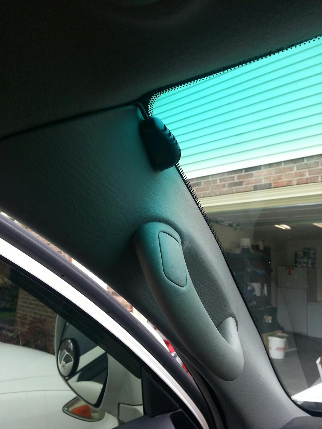

Where did you mount the microphone for the Bluetooth? Also, do you have any idea what those black pads are for that came with the microphone kit?

I mounted my mic at the top of the A pillar.
Not sure what the black pads were for, mine went into the garbage. I assumed they were to hold the cable down or something if running along a flat surface since they were sticky on one side.
