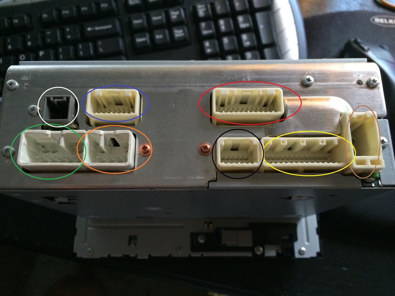

My next question that [MENTION=84709]Buckles[/MENTION] or someone else might be able to help with is on the back of the Scion head unit (below) which ports control what?? In other words what port is power, what port is steering wheel controls etc.??
I haven't pulled the JBL head-unit out yet and its been a while but I think it only has 3 ports on the back of it. Any hel:help:p would be a step in the right direction. There is enough smart ppl here to figure this out.

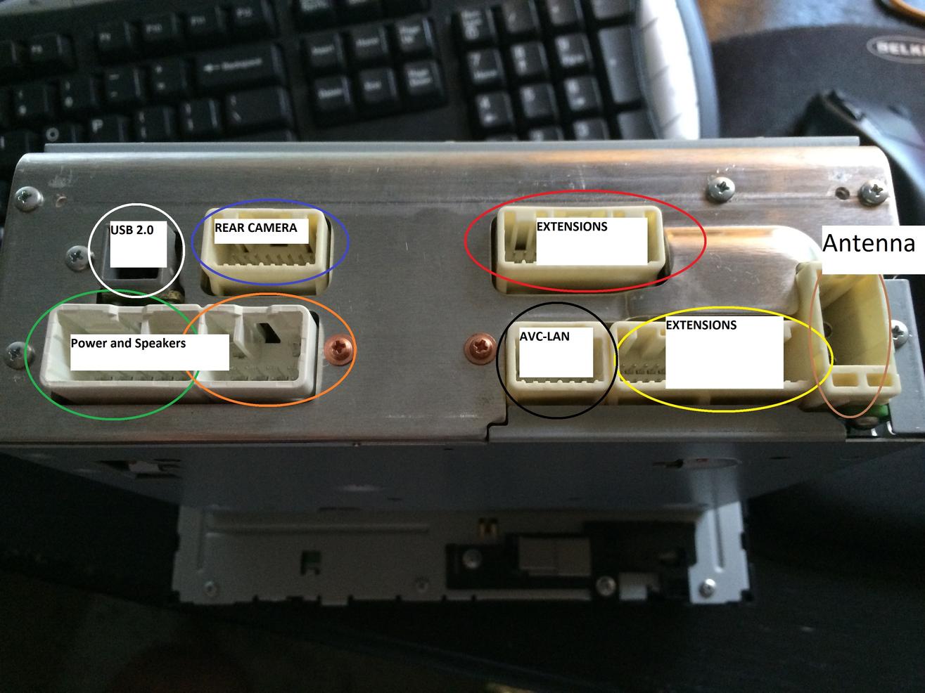

Found some useful info
I did some more research and found the answer to the second part of my question above. Was able to find the pinout here for the Sion head unit (I know [MENTION=50507]CookieRoe[/MENTION] was searching for this) which I'll attach below. Not sure if this helped me or just made me more confused
View attachment 2014_S-ADG-0158-D.pdf
