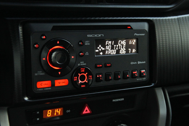

I don't have the model number, but it is the base stereo from a 2013 Scion FRS (not touch screen)

here is a pic.
as far as i know all toyota double din are the same size so yes it would fit fine
