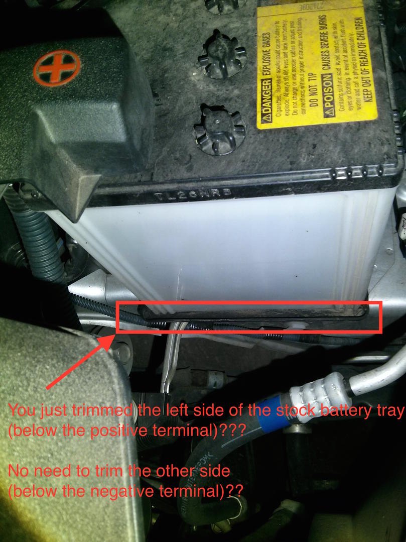

I took a picture of my 4runner:
1. I found that the stock battery tray is really a piece of flexible plastic. You can bend it very easily. It does not really support too much due to its flex material made ! The stock battery even extends from the platform without solid support from this tray !
2. Do you mean that you trimmed both sides or just one side of the tray? Pls see pictures attached? This big monster should extend further 2-3 inches without any support from the platform below.
I trimmed both sides of the tray and centered the battery as best I could on the factory mounting plate.
You can see in my initial pic that the 31M's handle center is just slightly offset towards the passenger side (relative to the battery mounting bar).
If this concerns you, I'd avoid anything other than a stock sized battery.
Otherwise, buy a 31M, nix the plastic tray (as Jeremy556 did) or trim it (like I did), bend the "+" terminal for clearance, slightly trim the plastic factory "+" terminal cover for clearance, and you are done :) Enjoy those extra CCA's and oodles of reserve current :)
Not a single issue over more than 24 months and 60K Miles and a 4KW RMS Audio System as a "Substantial Load" :)

I just trimmed the inboard side of the tray with my metal shears and that was it. Why is everyone buying those battery tray on here?
