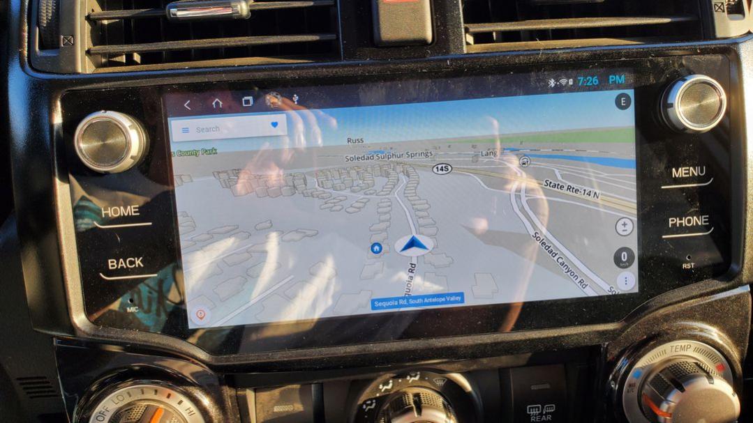

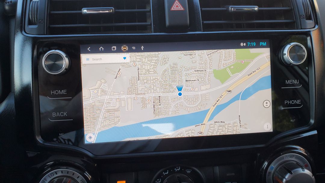

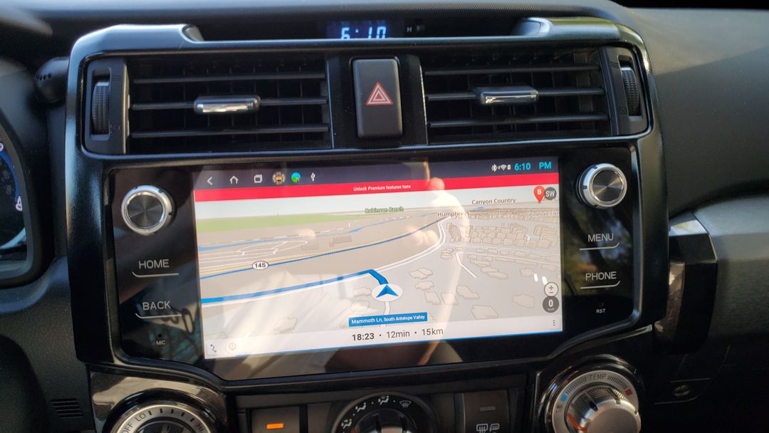

For navigation I am using SYGIC. It is free but is $7 for navigation addon or $26 for the full blown version. This is way easier to read while driving than google maps.

If you are interested in the Sygic maps I just upgraded to the lifetime World premium and its on sale right now for $12.49.

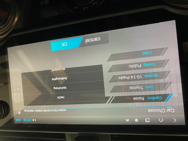

- The only real issue I've had has been with steering wheel controls. Initially only the volume buttons worked. I had to experiment with selecting different cars under Extra Settings until I got one that worked better. But once the back/forward buttons started working...they were reversed. Found another menu item that reversed them...so now all 4 of those work.

- I bought and installed Sygic for offline navigation. It's a good app, but feels a little choppy compared to Apple or Google Maps. But it's a good offline solution. You can download maps for states so you have that available to you at any time. I think at this point it would be my backup nav app if I was in an area with no reception.

- Can someone with a 2010-2013 4Runner tell me what they have for vehicle selection under Extra Settings / Car Choose? I've got a screenshot attached of what my current election is.

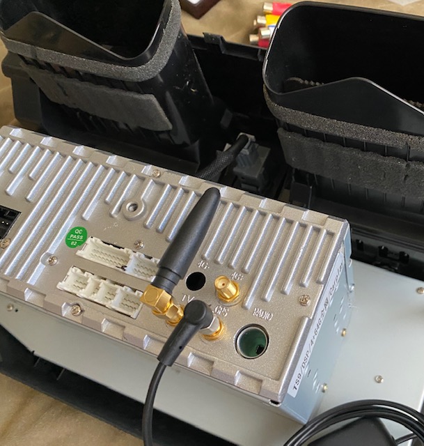

So I ordered the Rhino unit 2 weeks ago and it came today. Also got the front dash cam and the OBD2 Bluetooth connection.
Didn't expect it to come this fast...
I need to get my damn windshield changed out before I install. Got a couple nice big rock cracks and I don't want to mount the cam and GPS unit just to remove them again.
Anyway, looking at the back of the unit. Mine has GPS and WIFI labeled.. GPS on the top left, wifi on the right, bottom left is just a hole with no connector, bottom right has no label. I assume this is the tv antenna connection?
Mike, do you recall your connection configuration?
Attached is what mine looks like. I think you basically have 3 connections to contend with:
WiFi
Cell antenna
GPS
As far as I know, WiFi goes into cell and GPS into GPS.
Got it installed tonight, everything is smooth and looks great HOWEVER, the steering wheel controls and the door open notifications do not work.
I'm guessing the Canbus is not on? Is there a setting somewhere to turn it on?
I checked the Canbus module and it is nice and tight in the clip...so I'm guessing it's a setting somewhere. I tried the steering wheel app to set the buttons but nothing works.
Thanks guys!
I don’t think there is a setting to turn on. But there is a spot in settings somewhere called Car Choose. I think this is where you tell it what module and what car.
I would email Rhino. They’re slow and not very helpful but they should be able to help. You have 2014 or newer?
Yeah a 2016.
I did see that area where you choose the car, is set to the top one which is a Camry... Of course 4runner or Tacoma is not an option so I have no idea what it set it to.
