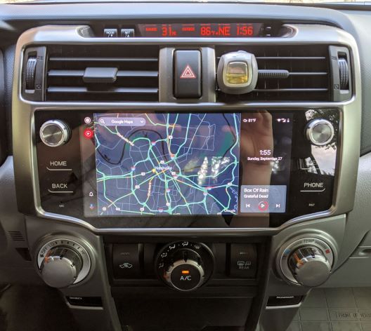

For the few Android Auto users out there... For anyone like me who has been using a third party dongle for Android Auto on their T9, I'm happy to report that you don't need the dongle. Kinda feel dumb that I didn't know this app was out there, but install Headunit Reloaded. It works really well. I haven't been able to get Android Auto to consistently work wirelessly yet, but connecting using the usb works flawlessly. Plus, and this is a big plus, Headunit Reloaded (aka HUR) also lets you adjust the resolution a lot higher for AA. I set it to 1920x1080 and it updates the page layout which makes Android Auto look so much better. See my pic below:

How do you get the home screen to look like this? I just installed mine and it looks nothing like this...
