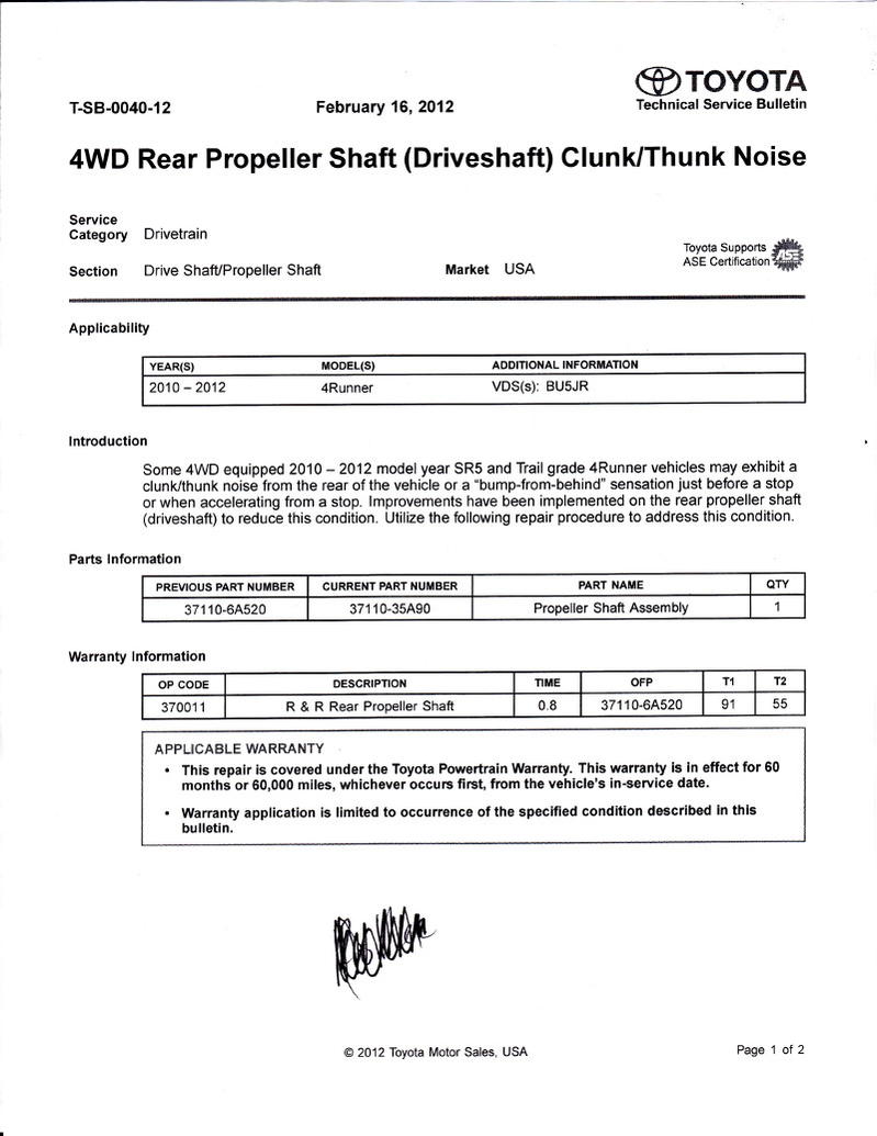

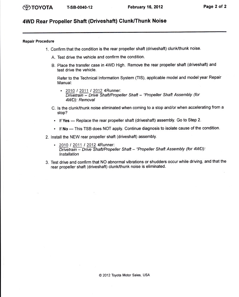

The only other TSB which have seemed to effect a lot of the members here is the one regarding the drive shaft "Clunking". Not sure it applies to your vehicle. See attached. Be Safe.
