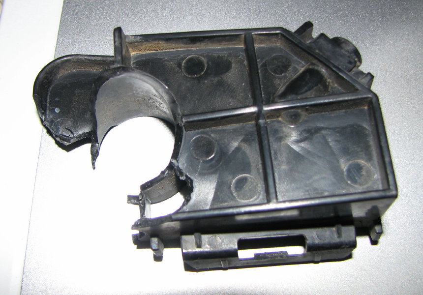

When I got home I carefully went over the front of the car and noticed the left front at the wheel well was loose and the freaking mount inside was broken. You know this happened while removing and they tried to cover it up.
Now I gotta call and be an a-hole again.
There are four screws attaching the fender trim to the bumper. three different sizes. Can anyone tell me which goes where?
Here's a pic of the broken piece.

Dealer put bumper back on differently??
Almost the same thing that happened to me. Our driver side was noticeably misaligned and loose. Haven't gone back to the dealer to have them fix their problem... It looks like the same piece. I think the piece goes near where the bumper almost touches the top/arched fender flare. (It's been a few months since I looked) I tried to tighten the piece on my vehicle but the screw just kept on spinning while the black plastic piece was wobbly. Not technical terms since I have no clue what these things are called.

There's a new part so it was probably redesigned.
The material was this:
10 Support, Bumper Cover
R 52115-35140 $37.78
L 52116-35130 $37.78
but it has been replaced with:
Toyota Part: SUPPORT, FR BUMPER S
Part NO.: 52116-35131
278,394
