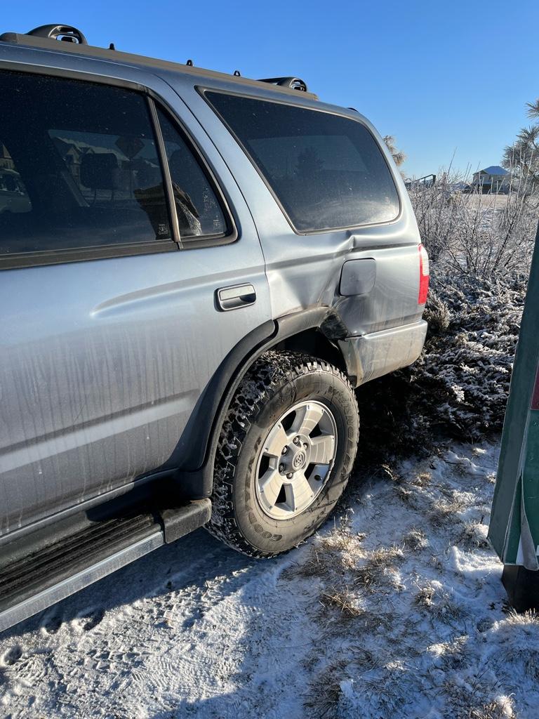

This is part technical and part judgement. For some reason my 97 4Runner has grown on me. It has grit. My son drives it as his first car. I daily drive my 5th Gen.
When we got Auzz, the idea was to restore it and use it to start teaching basic mechanics to my boys. Mods, Colorado and Utah trails and camping, etc….
Well ice and snow happened and a tree into the left rear quarter panel. How hard is it to fix something like this? Due to the age, body shops are talking about totaling it due to potential inner liner damage. I’m not a fan of trashing a perfectly running car. Body panels look to be rare and most likely will come from a used doner some where.
Mechanically he is still way strong. Before us it was a well cared for Runner.
Should I keep pushing for the professional repair, try to pull it out myself and cover it up, just give in a total it? If your in the Denver area and have knowledge of good body shops willing to restore let me know.
