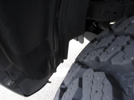

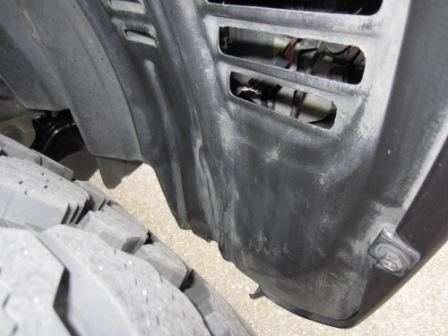

Sometimes the inner fender rubbing can be handled with a heat gun. Wear gloves for this. Heat the liner till its soft and pliable, push and hold it in with your hands till cold. A bag of crushed ice pushing on it speeds things along too.

I used a heat gun on mine, I was to lazy to crawl under the rig. No gloves needed either. Just a heat gun and a screw driver handle to do the pressing.
5 minutes and it's done.

Dealer installed the lift as part of the sale and had the alignment done as well (Paperwork included). The heat-gun technique worked well on the drivers-side but note so well on the passenger. Where it rubs on the fender-lining there's a "seam" of sorts that made the heat gun technique more challenging. Would recommend applying heat for 30-45 seconds then shape using a large blade screwdriver or other flat object. Keep sharping with heat application until you've got the clearance you want.
Moving the liner is extremely easy. It took me about a minute per side. In front of the wheel, under the bumper there are two (I believe) screws (hex head). Just unbolt them and push the liner forward. Then screw them back through the plastic. You do not have to drill a new hole. I just pressed up on them and they screwed right in.
