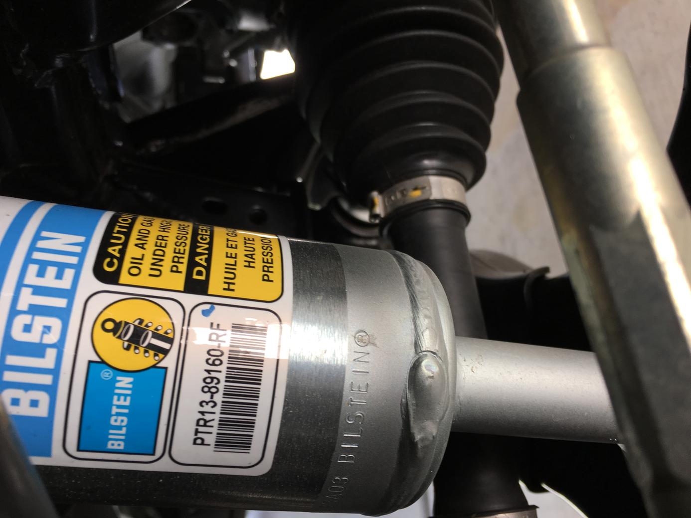

If you've bought a TRDP recently (within the last month or so) you will most likely already have the updated suspension in your vehicle, but poke your head underneath it to check your part numbers for the front struts against these which are the new part numbers PTR13-89160.

My TRDP is two days old. Just crawled underneath. front billsteins have part #s PTR13-89160-LF and -RF. So looks like I've got the revised parts.
Just picked up my Pro last Sunday. Came off the ship June 6. Have the old part number "50" not "60". But since I'm in CA and plan to going skiing maybe 2-3x/yr at most hopefully I won't get the clunking noise.

Looks like I've got the revised parts.
