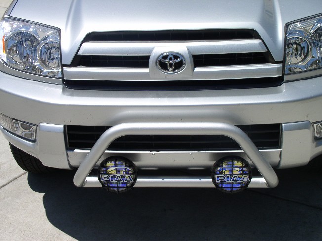

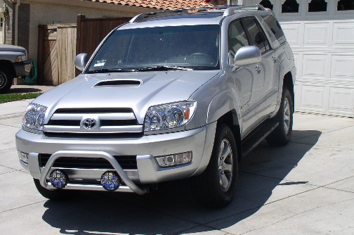

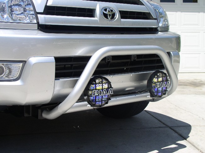

heres my picture of the newest addtions...
the whole install took about a hour to complete the only pain about it was trying to fit the switch plug through the itty bitty hole on the electrical grommet, other than that it was a piece of cake.
heres the cost:
westin safari bar $117 @ kragen auto parts
install kit for bar $37 @ kragen auto parts
paint job (paint code 1d4) $125 @ vorhagen auto body in brentwood, ca
piaa 520 ion crystal $190 @ american off-road in antioch, ca
--let me know what you think--

I am a little jealous for I was shopping for the 510's and nobody had them in stock, and the 520's according to Safari's dimensions they were not supposed to fit. Well you shown they do fit; oh well I like my existing PIAA's which I hardly ever use anyhow.

thanks, i was wondering if they would work to after what you said. maybe the guy was just trying to push what he had in stock (u know salesman) but anywho i love the lights so far. at night they give off a yellow purple light which lights up much better now with my low beams. all i need to do it run a wire to my parking light so they will auto off with my headlights and aims the lights accordingly- i was too tired to do it last night
It looks really good! I was thinking of getting the same light bar. It looks good on your rig and sounds like it was easy to install.
