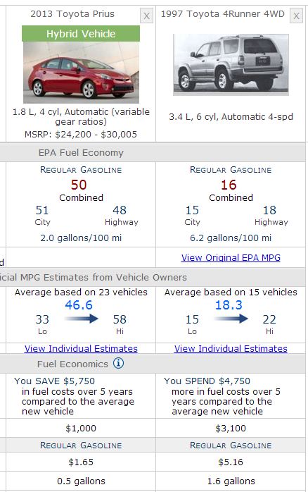

If you want better than 18 MPG buy a Prius.
:boink:
