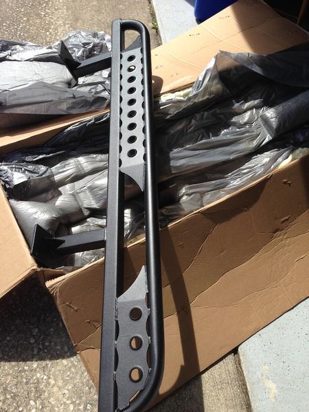

Prepping, priming, and painting all the armor I bought :-). MT OPOR sliders and a full RCI skid set. It's a lot of metal. About half way done at this point. Should get it finished tomorrow and installed Sunday if everything goes right.

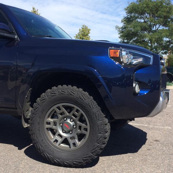

It was actually yesterday but, I got the front end lifted! Bilsteins at 1.75" Definitely gets rid of the rub from the tires and provides a way better ride.
Front driver's side was at 34.5" and is now at 36 & 7/8".
Front Passenger's side was at 34" and is now at 36 & 3/8".
Mind you these measurements were done on my garage floor. As level a surface as I could find, lol. After measuring it looks like I got 2.5" out of it! Looks great though!
That's awesome! I have the same set of sliders at the powder coat shop and I just primed my RCI skids today...

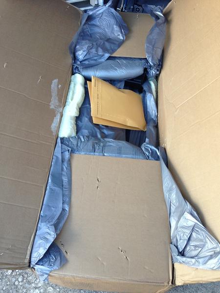

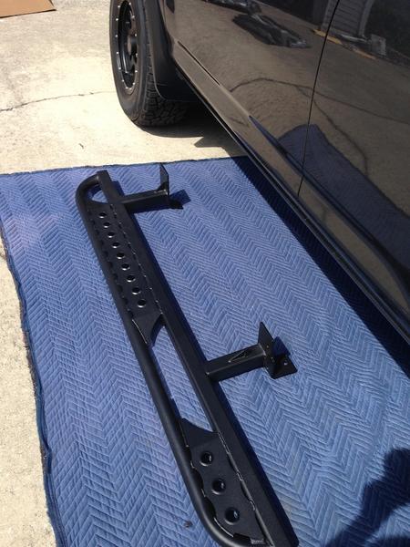

Received my sliders yesterday evening. Excellent packaging! Here are a few pics of them unpacked and installed. These were so much fun to install. :censored:
However, after a break and patience got them done. Hope you guys like!
Now to update my sig!

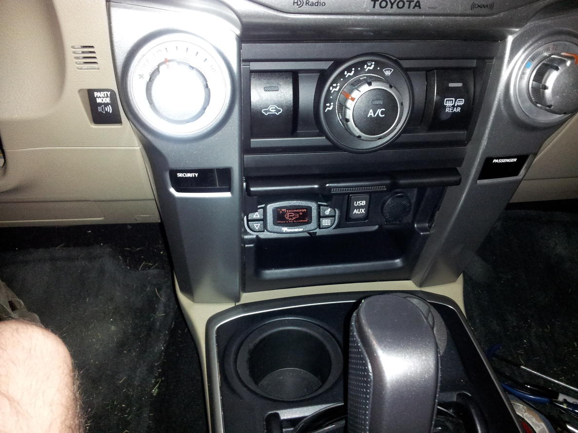

Finally installed the Tekonsha P3 brake controller today.
