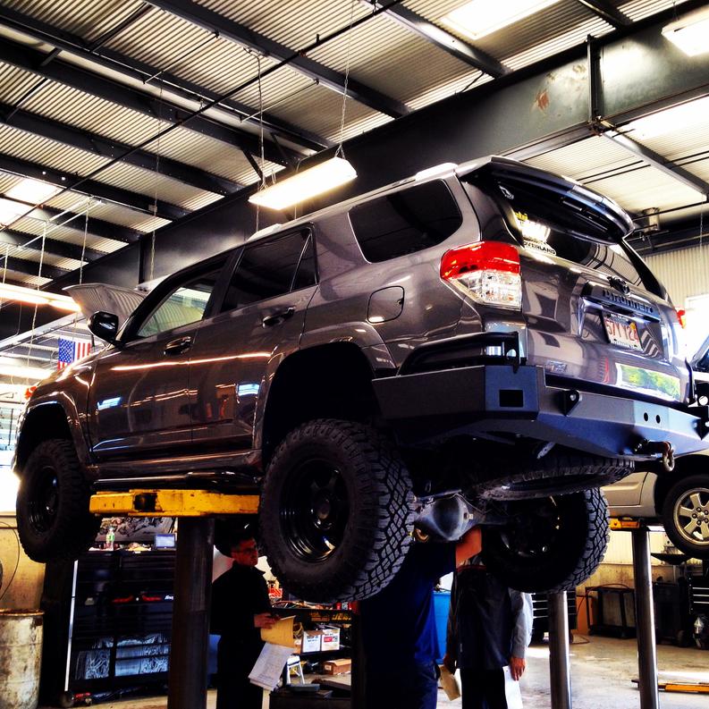

Threw it up on the lift today to replace all fluids. Also fixed my rear sway bar double disconnect end links. Also had to heat up and bend the exhaust hanger so the tailpipe wasn't rubbing on the bumper brace.

I had to add washers between the sway bar and bolt so it would straighten out the angle of the heim joint. There was space in between and it clanked pretty good over bumps.
I had some clanking also but mine was due to having some play at the top disconnect. That was installer (me) error. Tightened it up when I rotated the tires and it's been pretty quiet since.

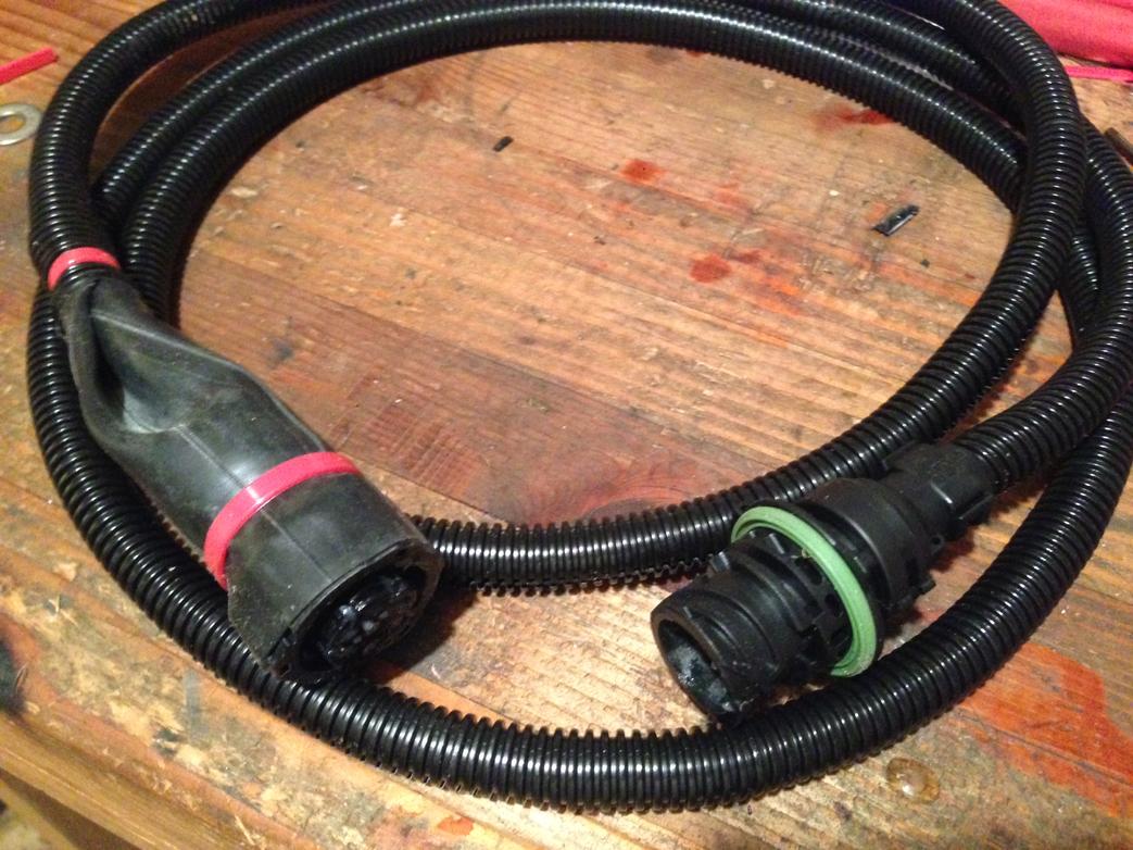

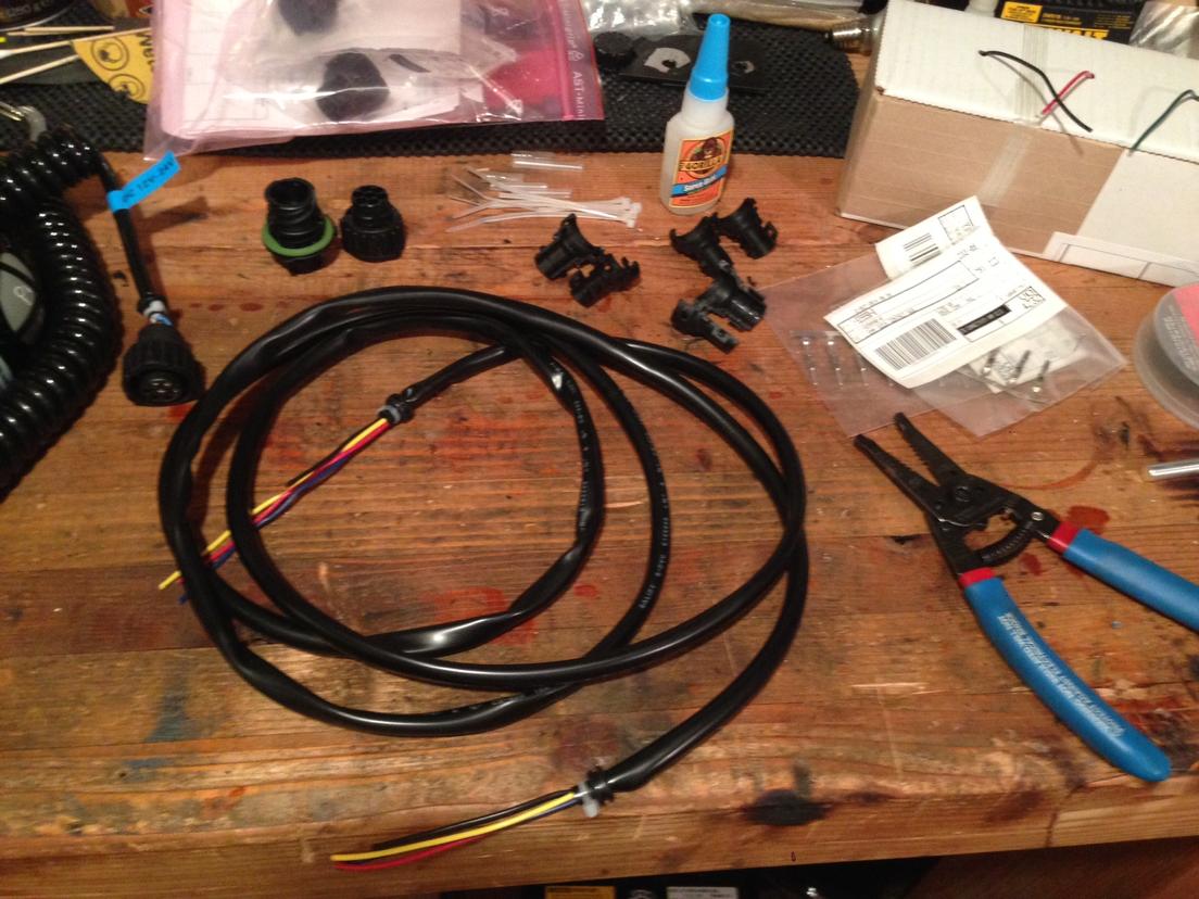

Did some of this and that :) Changed out my coil-overs to support the extra weight of everything else. Oh and turn a pile of pieces into a Remote control extension for the ridiculous Superwinch non-standard Talon remote socket/plug combo :mad2: It is not even the fact that I called Superwinch and inquired about something they had absolutely no answer for... except buy another remote and socket assembly and hack them all apart. Not that I minded tearing the original apart and searching for hours to find and acquire the all pieces from a company that is so huge that I think they manufacture every connector on the planet. Can you tell that bugged me a little bit, not the building, just all the work prior to that, thanks god for the interwebz :D
