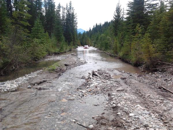

The front wheel bearing failure (both at the same time) occurred with just 45000km on the truck and came on fast this winter with no previous signs more that a couple weeks earlier. The only off roading has been BC logging roads. I only did the one water crossing twice (out and back to a no longer secret fishing hole) but it was a big one. Max of 24" deep and the hubs were submerged for over a minute. The crossing was not a large river but washed out the road so it was almost 100m long of water.

This was the crossing, not me but a ram truck following me through
