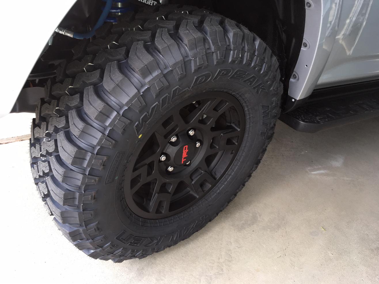

I had 265/75/16 on my 2002 with billies at 2" lift, they were the Wildpeak M/Ts. I really liked the feel of them, not bouncy, or ruff riding, but a more solid feel. I like the idea of a tougher, or stronger tire on a 4 - wheeler even on the pavement, i liked them enough that i took the Grabber At 2s off of my 2017 with 400 miles on them, and put on the 285/70/17 Wildpeak M/Ts. The difference i notice most is braking, not terrible, or really bad, but it does take a little more peddle pressure. I do not notice much on take off from a stop, i mean come on it's a 4 x 4. Just my nickle on it.
