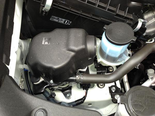

Can someone please explain what is this. In the future i was planning to do dual battery setup and i see there is another group buy going on. But i have 2013 sr5 and where everyone place second battery i have this instead
It is the AIP (Air Induction Pump) now on all 13+
Your 4runner has this right? Have you taken a close look at it to see if it's easily relocatable for a dual battery setup? I noticed this too at the car show last week and was thinking what a bummer that is for the 13+ owners that want to install a second battery :(
That DOES suck!
Hopefully when more peps have them somebody will figure out how to move it.

For those who has double battery setup in two different parts of engine bay and also have air compressor, can someone please measure the length, width and height or the tray and air compressor. I want to see if the tray with battery would fit on the other side of the intake closer to windshield on the right side of the engine bay and if air compressor will fit next to new AIC toyota placed like it is on the picture.
Thank you in advance!
