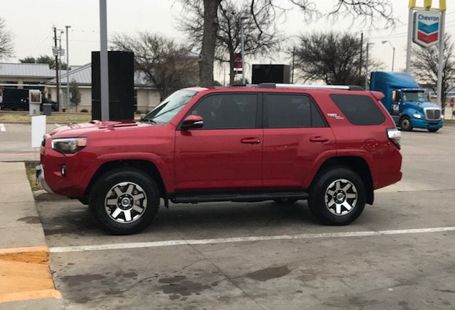

2018 SR5 4X4 Prem bone stock suspension under 1k miles
front 20 3/8
Rear 21 3/8
next step Tires any suggestion

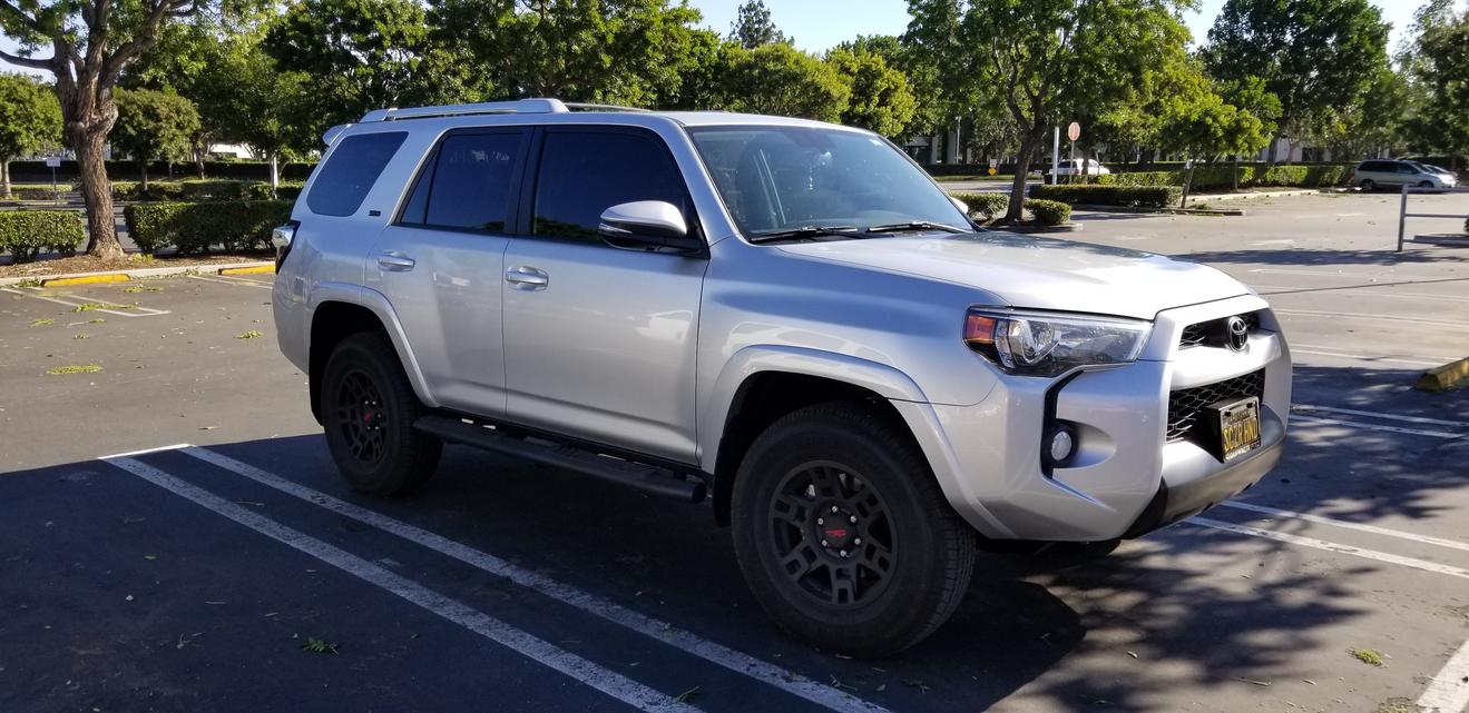

Factory TRD Pro with Cornfed 1.5/1” spacers added with 275-70-17’s. Front:22.5” Rear:23.25”

The Pro model is ~1” higher in the front over all the other 4Runner models. Rear is the same. The Pro also comes with the fender liner cut mod from the port. Are you planning on running 275’s?
Already running 285/70/17 and have 2883 front and 2895e rear springs. It seems to have given me a dead on 2” lift all around vs oem. Which i believe was like 23.5 rear and 21.5 front fender to hub measurement. I need to double check again though for sure. I moved the fender liner forward and cut the bottom bumper edge so i have no clearance issues.
just double checked my measurements and indeed it is 21.5F / 23.5 R which means I can go up another inch so the froont is 22.5 like yours and I should be able to get caster in spec with oem arms.
One inch up front will give a more level look. As far as UCA’s it depends on your wheel offset also. The slightly larger 285 will push it a little closer. I will probably run 285’s the next time around.
