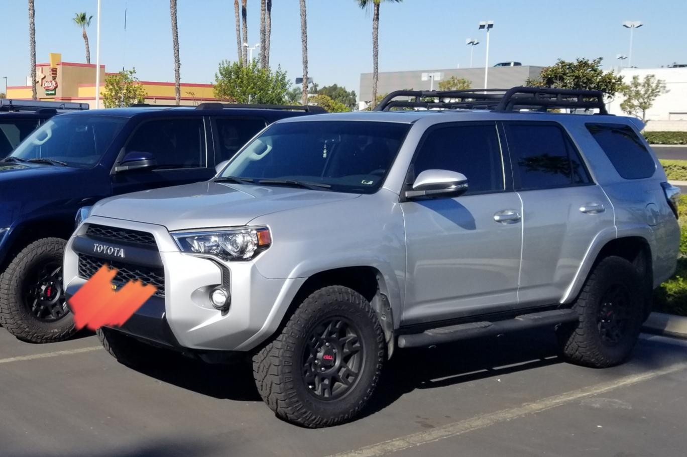

center of hub to top of fender measurements
2018 SR5 4X4 Prem bone stock suspension under 1k miles
front 20' or 51 Cm
Rear 21 1/4 or 54 Cm
next step Tires any suggestion
after lift and tires
Front 21" or 53.5 Cm
Rear 22' or 56 Cm

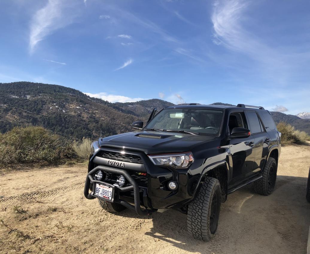

For my rig as described in my signature below, the average measurements are:
Front: 22.25”
Rear: 24.0”
When I say “average measurements” I mean to say that there are constant inconsistencies in the tilt or lean that i think is an artifact of the KDSS system, the lift, and how I drove/turned immediately before parking on a level surface to measure.
Bilstein 5100’s with OME 885 front springs and toytec super flex rear coils.
Carrying about 400lb of weight at all times (Bumpers, etc).
