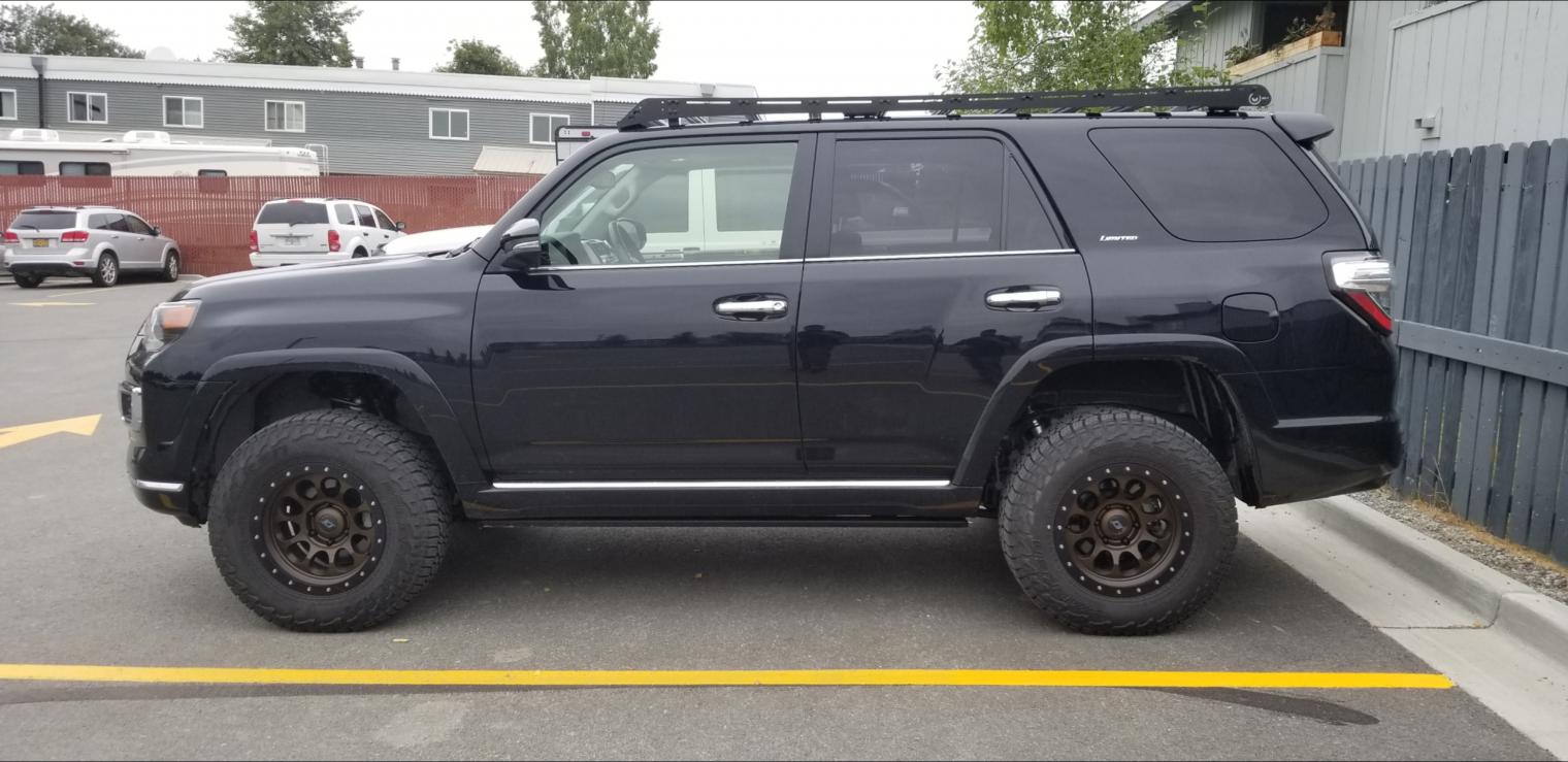

Here 's an update to how she sits.
Front left and right 23.5"
Rear left 24.25"
Rear right 24.125"

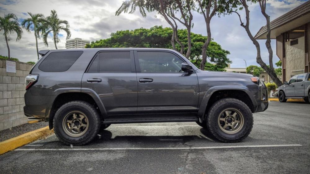

Stock 2018 orp 3500 miles unloaded.
20 front and 22 rear.
Pic after lift giving me 22 front and 23 rear.

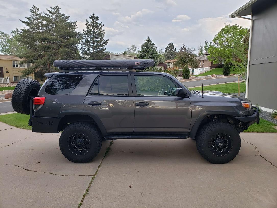

I ripped out the XREAS and installed Bilstein 5100 all around with OME 885 in the front and OME 889 in the rear with SPC UCA's.
Full Tank of gas
PF 23 1/4
PR 24 1/4
DF 22 3/4
DR 23 3/4
1" take and .5" difference between sides with full tank. On the limited with the lower bumpers it doesn't look as tall as other 4runners.
Where I'm parked is a slopped parking lot so the back looks high.

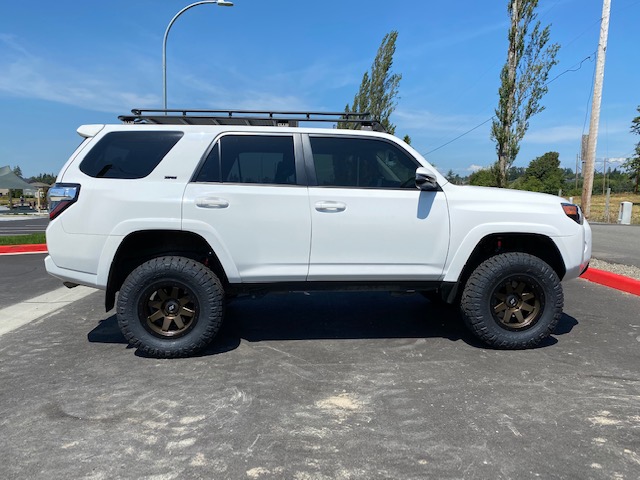

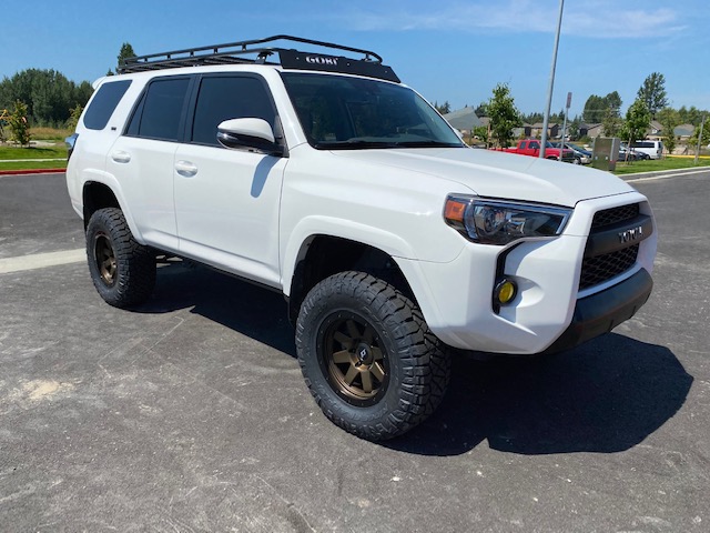

I measured 23" Driver side 22 3/4" Pass
25" Rear
Toytec 2.5 Aluma Series Suspension with Heavy Duty SPrings in rear
Toytec says the HD springs are 1" taller, thinking im gonna go with the normal springs to lower the rear an inch to level it out.....

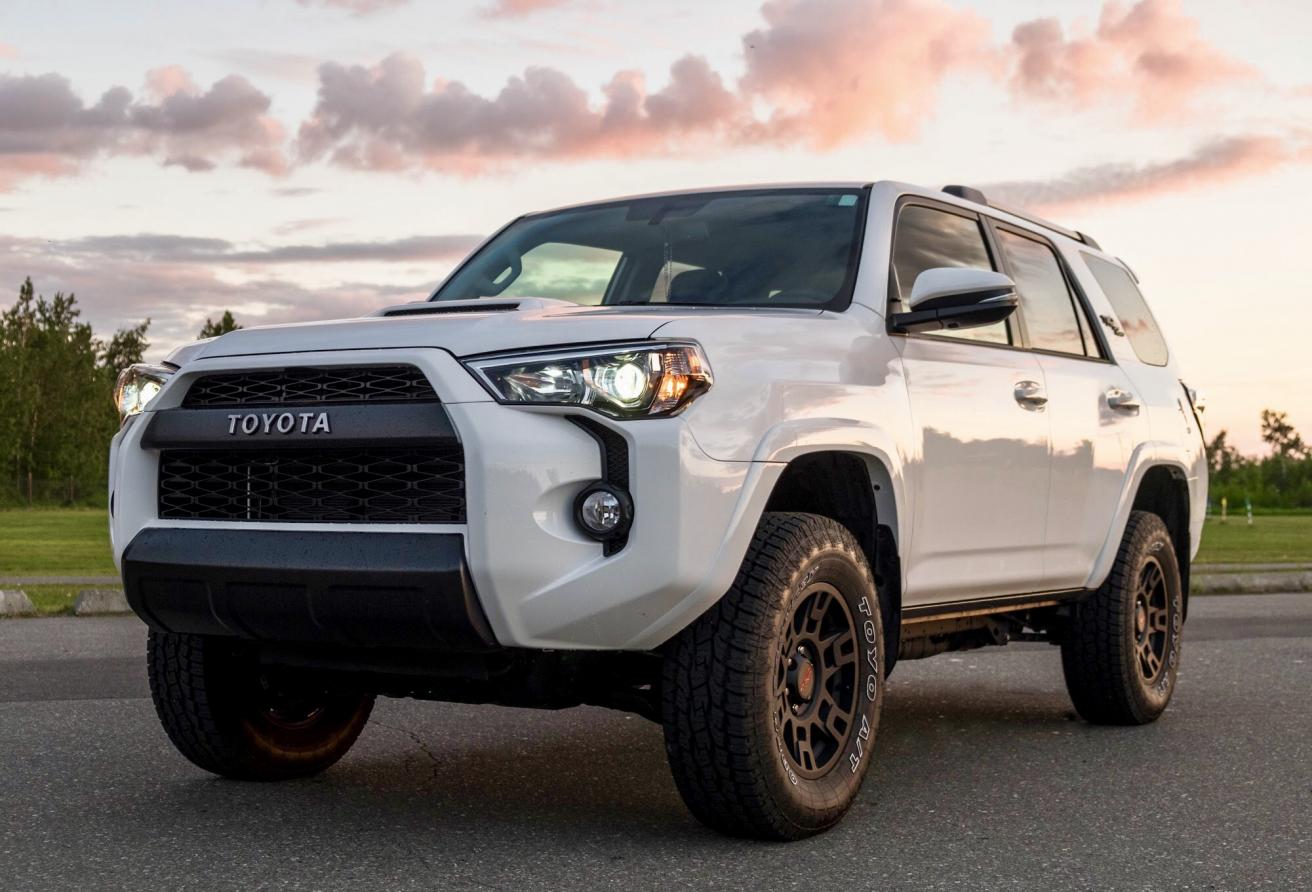

Wanted to update my measurements.
Now
Front: Stock TRD Pro Bilstein shock + TRD FJ 3x14inch spring
Rear: Bilstein 5160 shock + Eibach 1inch lift spring rear
Front Driver From Center Of Wheel 22
Front Passenger From Center Of Wheel 22.125
Rear Driver From Center Of Wheel 22.625
Rear Passenger From Center Of Wheel 22.75
