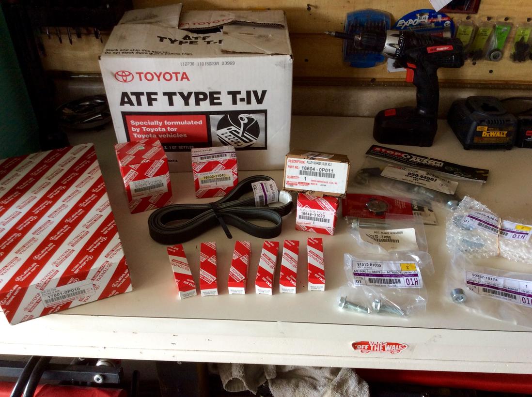

Thank you for this write up.... I just picked up at local dealership my All new pulleys no.1 no.2 no.2 , serpintine belt,pulley bolts, pulley washers, pulley spacer and added new air filter, oil filter along with new spark plugs.
Now to just get started....
