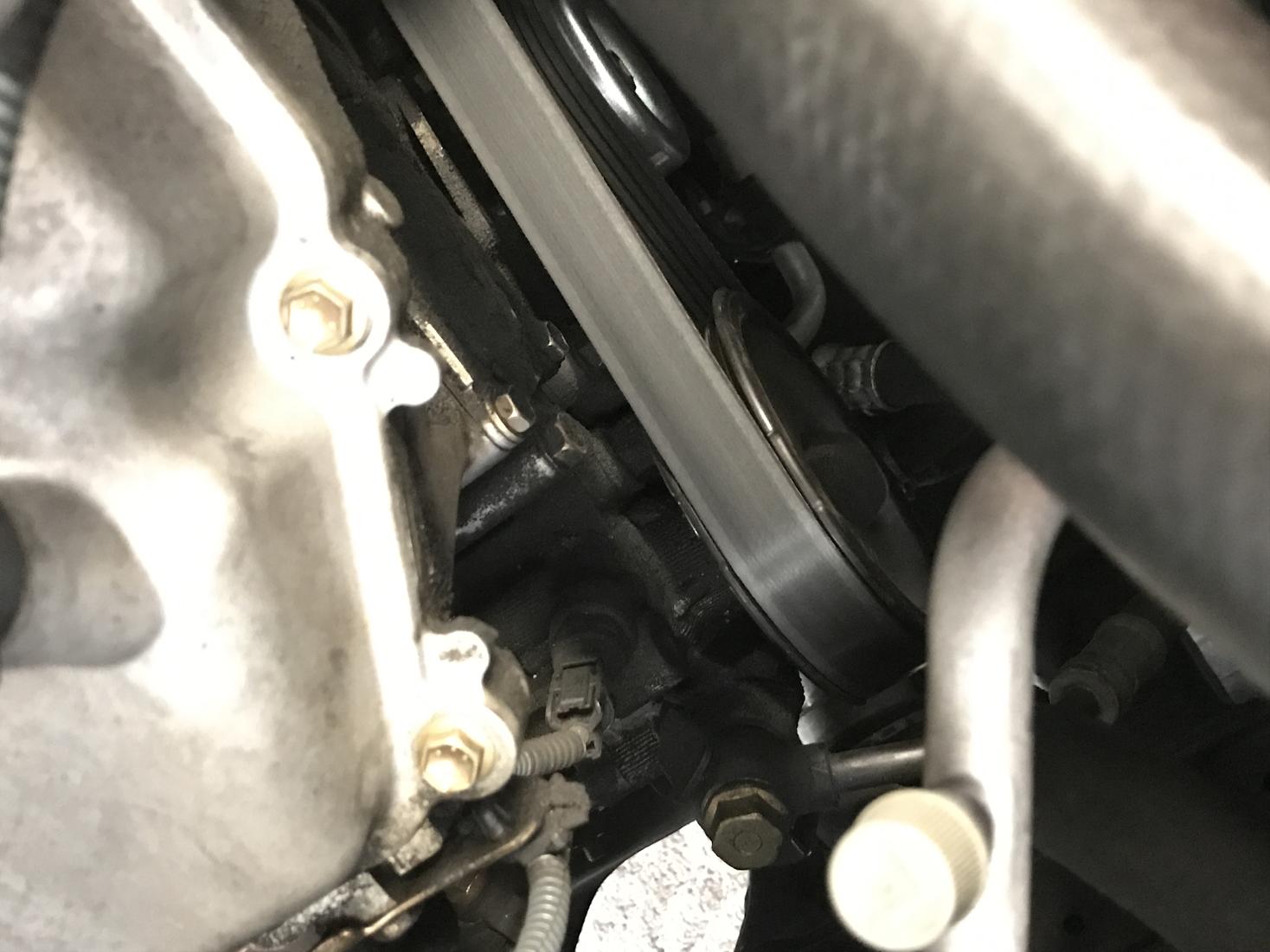

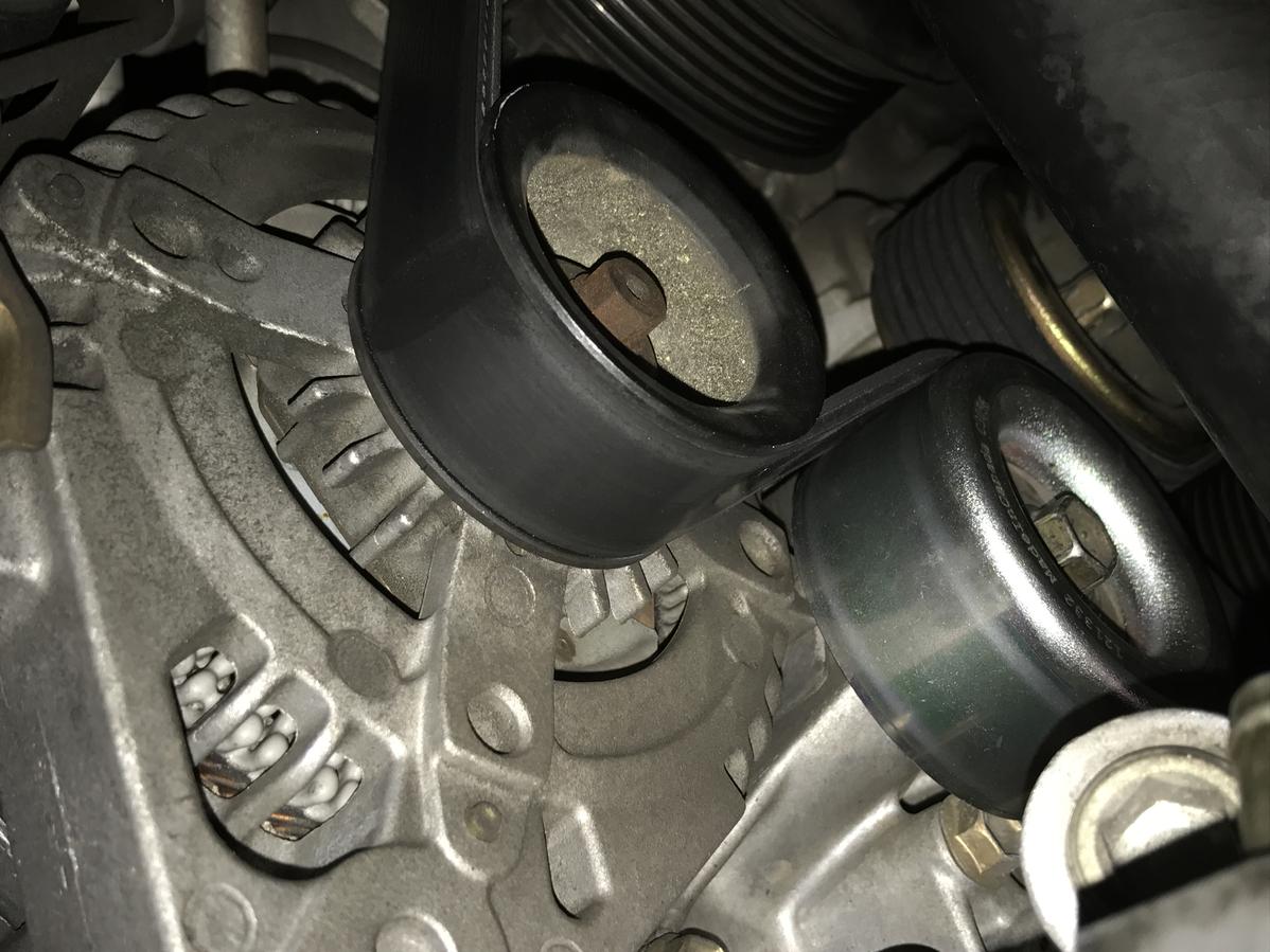

If you look on the edges there is some sort of wear. I checked the route 3 times and I drove the car for a good 10-15 min with the AC on. No weird pulley noise.
This may be something completey unrelated or something I've never noticed, but when I accelerate now I hear a clicking noise. No click at idle besides the normal v6 click.
145k on the ODO
