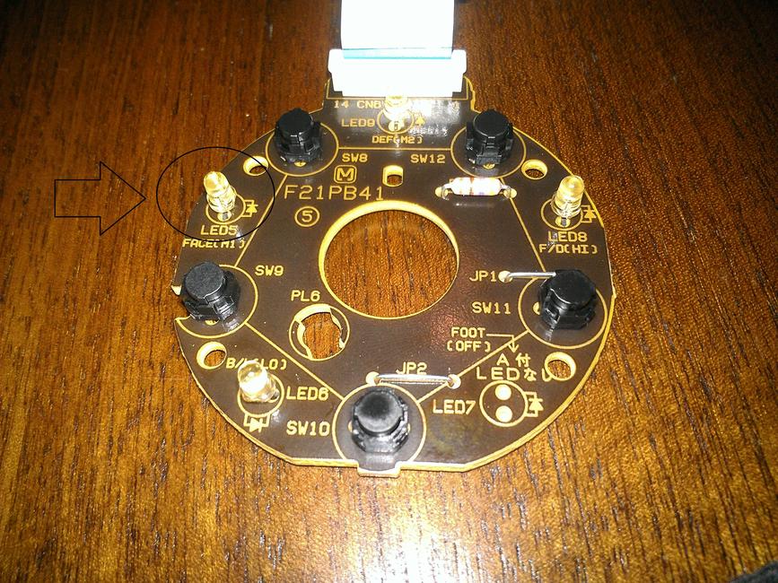

Frustrating. What about these LED's that are actually soldered on the board. The fan speed and temperature knob are out. I'm not looking to change colors just want to be able to see at night :(

Those LED's soldered on the board no longer illuminate. I took apart the far left dial to reveal that these don't seem to be replaceable?
I couldnt find that part number on there. If I we're to go the DIY route. What exact LED's would I get
They are replaceable and I replace em every week pretty much.
3mm flat or round top LED. Don't overheat the board though. They're very delicate.

Even if I do fix it would break a week later? Sounds like a pita. Should probably just get new board? Can you send me a link to the parts. Doing a Google search for 3mm round top LED's provides many options lol
It shouldn't break if you do it right...

There a guide on on this or is it as simple as desolder, insert LED, cut to size and your all game?
Are these it - so many choices.
3mm Round Top LED - Orange / Amber
Yep those are it.
Longer side is positive. When you look at the brown side of the board, you will see the arrow diagram. I always think "positive goes to negative" so positive > negative. And there ya go!
Desolder, remove, insert new LED, bend legs to hold in place, solder, trim legs, happy happy happy

Those soldered LEDs are only the indicator arrows that light up when you select that particular function/speed on the knob.
If you are just talking about the backlighting for the knob itself, you can pick up replacement bulbs at the dealer or get some Neo bulbs (it takes 3 to replace all the HVAC knob backlighting).
The thing is I have the limited with the dual zone. The right side temperature up/down selector is the only one out. So I figured it was the soldered LED's.
