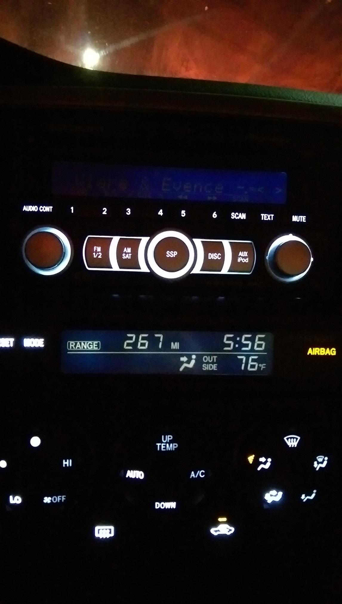

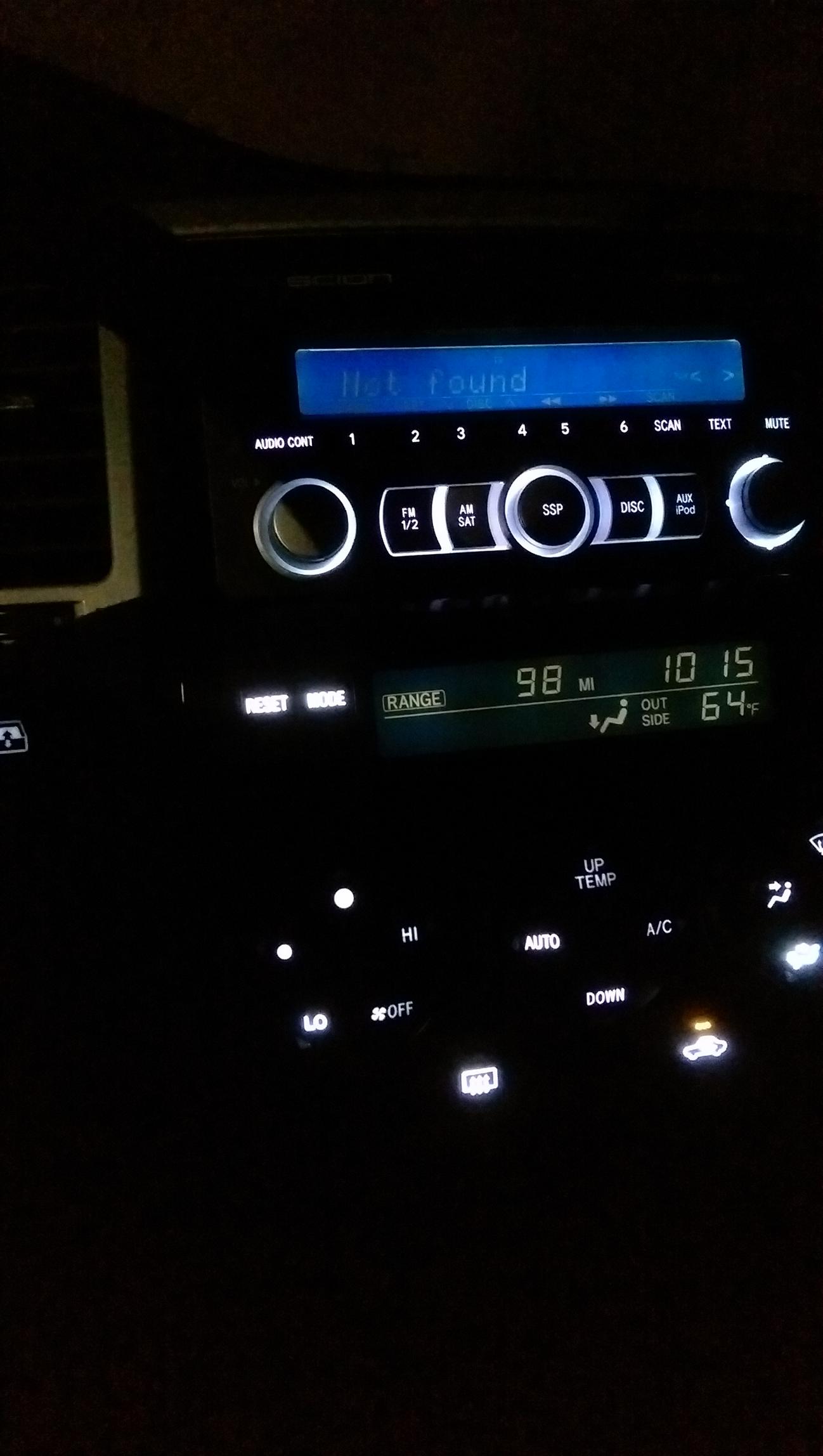

I changed out the LEDs backlighting my stereo (haven't done it with the HVAC yet, but I suspect it'll work similarly except there might be hotspots) to more of the same LED, but with a resistor with half as much resistance (150 ohms) again.
Daytime does not a lot of difference since more of the light used to see it is from the sun than the backlight but it did help a little.
Night time however is ridiculous. The phrase "night and day" comes to mind.
I did two things to the LED backlights on the stereo LCD: pointed them more directly toward the diffuser plastic piece behind the LCD, and halved the resistor's resistance for each.
Awesomely (by which I mean badly) contrast-balanced pictures are attached. For comparison, note that all I changed between the two pictures is the stereo LCD backlight (and I fixed a broken backlight LED on its right dial; and the car changed location; and the camera angle was a bit different). Before has a broken left LCD backlight as well, but the right side is as bright as it was before it was broken.
So I know not too many of you care about my stereo work but my point is: we could apply this principal of halving the resistance to the HVAC (and possibly getting some nice plastic diffuser film or something to anull hotspots). Same concept as the 12v mod: the LEDs take the same ~3v regardless, we're just letting it have more power by raising voltage or lowering resistance, which balances out in the amps. (The amps control how bright the LED ends up being.)
The only potential problem here is that too much cranking up the power will kill the LEDs faster by making them melt themselves, although mine haven't died yet so 150 ohms (at the original 6 or 7 volts that the stereo backlight contacts give) seems to be ok for the moment.

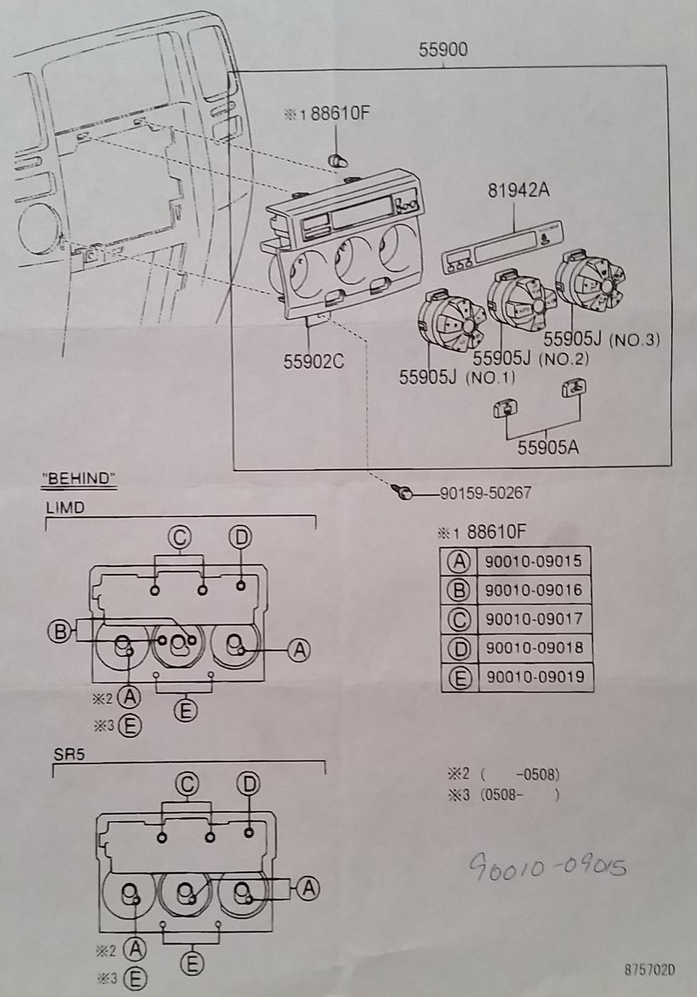

im going to throw this in here just in case others are looking for the OEM bulb info in this thread.
