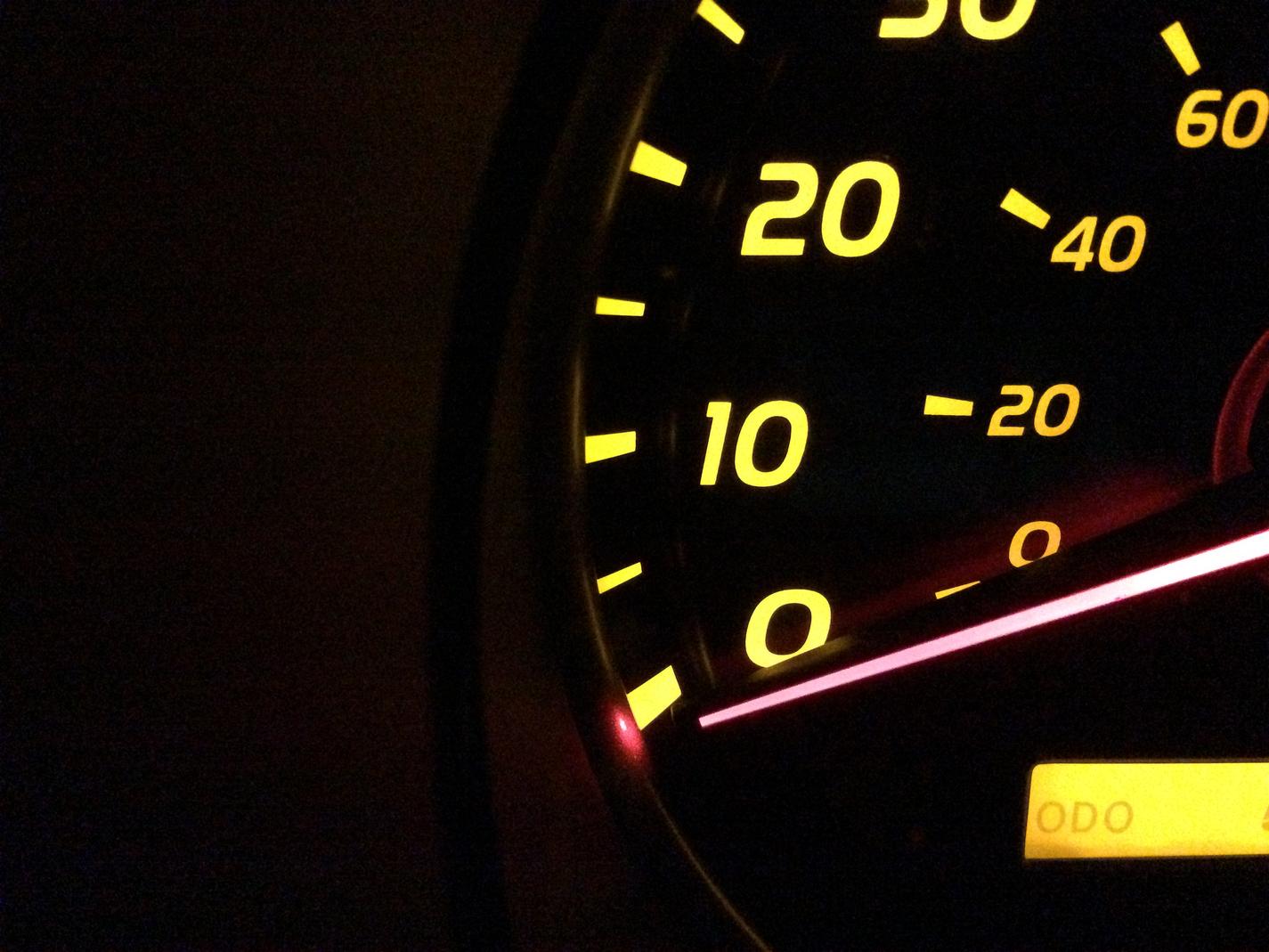

One more thing I meant to ask.... On my Limited the needs are red as you know. I would like to make them a deeper red if possible. I'm not too found of the red/orange that they use. What is the best way to accomplish this? Also, the tip of the needle shines out onto the surrounding bezel. I want to make sure I keep this function.
Please see the attached picture.

The OEM needles use red LEDs. I have found them to be the same color as the aftermarket red LEDs. Only thing i can think of is to scrap the OEM orange and paint your needles red?
My suggestion would be to take the needles apart, sand the red coating off the front and the chrome coating off the back. On the back of the needle, apply some white paint (Testors model car paint would work great for this) and then you will get a red that is much closer to the color of the leds behind the needle. That factory orange/red color drove me nuts as well. As long as you don't get paint on the tip of the needle, you will still get the light shining through onto the edge of the gauge face like you want.
Here is a video I made on how the Limited needles are taken apart and modified.

Yes, my needles are white but the leds behind them are blue. If you were to leave the factory chrome coating on the back of the needle, it is actually too shiny and won't grab the light like the white paint will. Here are some pics I took before doing the white on the needles.
Here is what they looked like lit up with the chrome coating.
Here is what they look like now after the white paint. It made a huge difference in visibility.
To answer your question on the shifter lighting, it will still be a bit orange even when using a white led in place of the bulb. The P is the only letter that will light up pure white. The rest, minus R and N which are going to be orange and green no matter what, have a bit of orange in the plastic. Here are some pics with it taken apart and with a white led module in place of the bulb.

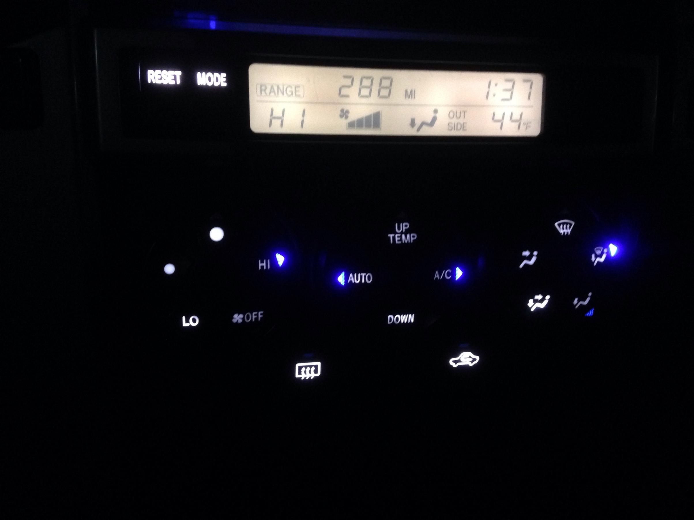

I've been working on the HVAC panel today. Most of it looks good except the 3 knobs, which are really dim and uneven in brightness. I used the standard neo3 LEDs from superbrightleds. What's a brighter and wider pattern led for these three knobs? Can I use the HP neo3?
That's how my climate controls look too Garyn. Did you get everything ordered for the cluster? Are you going to attempt it yourself, or do you want some help with it?
