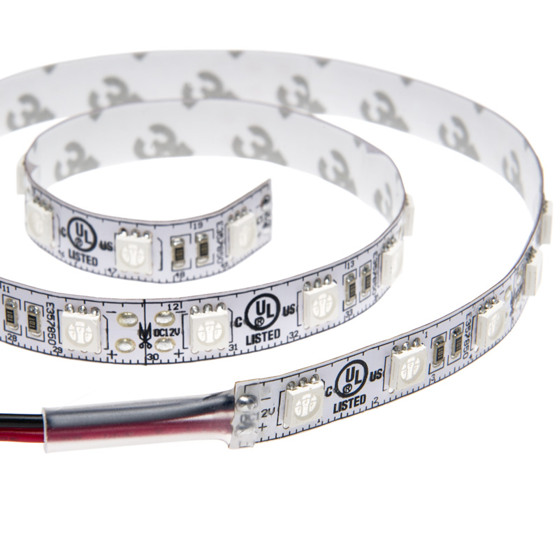

Not completely happy with the brightness of the reverse polarity mod WITH the 12V mod, ordered these:
Even with the NEO bulbs, you only have 2 bulbs (LEDs) trying to light up the HVAC display. With these (pic below), you have 18 LEDs/ft. Our displays are 4 3/4" or about 5". That's about 7 LEDs per strip. What I had in mind was to put 2 strips in there. That's a total of 14 LEDs. These LEDs are also the brightness they had in the color/size we need. Will report back with Alex's findings.
linky: https://www.superbrightleds.com/mor...leds-per-foot-3-chip-5050-smd-leds/1465/3284/

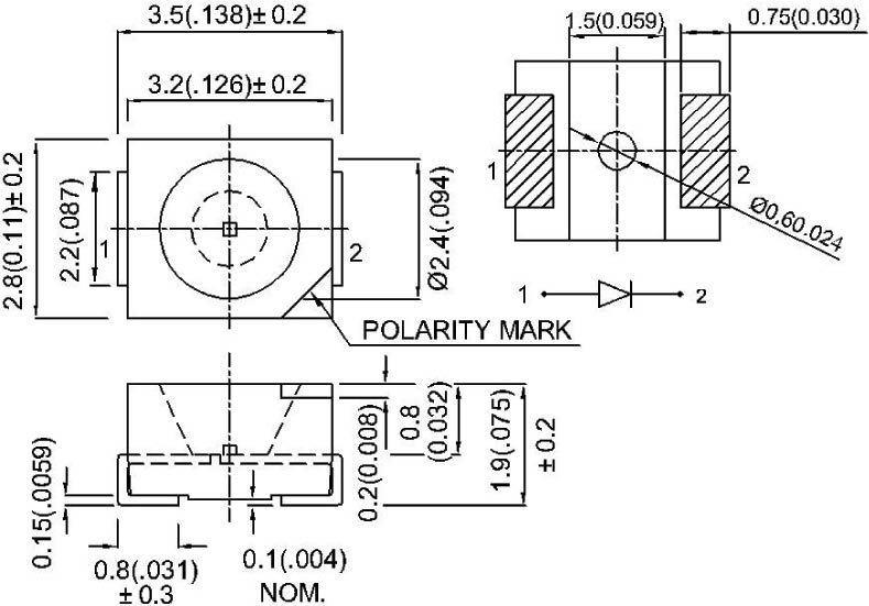

I have one simple question. I know the board has the arrow on it for the LED. How do you determine the direction on the LED itself? I have never looked at this type of LED before.
Thanks
see the attached photo taken from oznium's site that shows the polarity mark and how to be able to identify direction.
i highly suggest you take pictures of everything with a high resolution camera to be able to double check in case you have any questions during the job. do this BEFORE you take off any LEDs.
