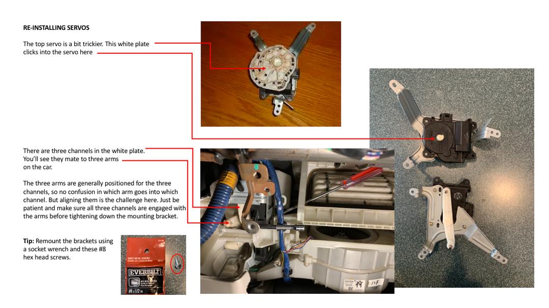

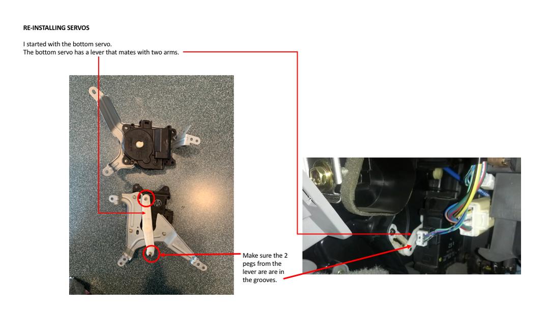

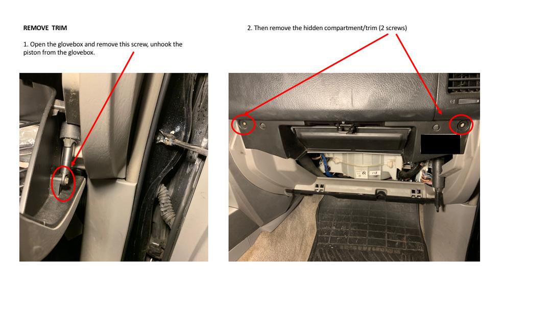

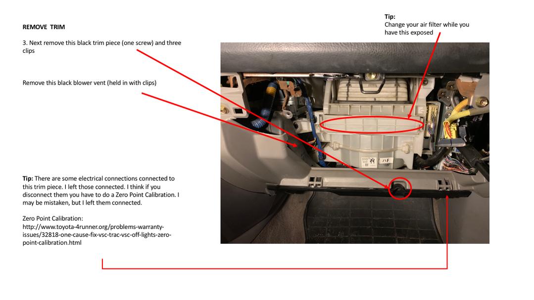

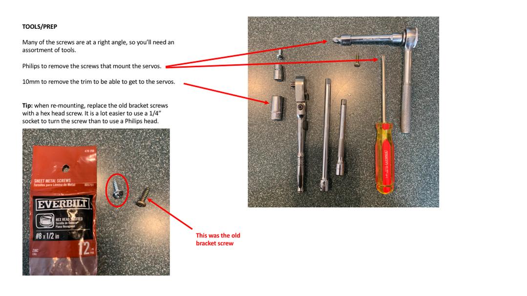

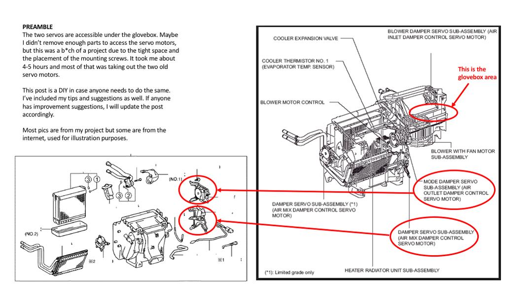

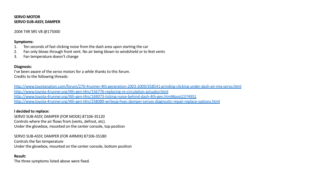

Symptoms:​
1.Ten seconds of fast clicking noise (so fast it sounds like buzzing) from the dash area upon starting the car​
2.Fan only blows through front vent. No air being blown to windshield or to feet vents​
3.Fan temperature doesn’t change
I decided to replace:

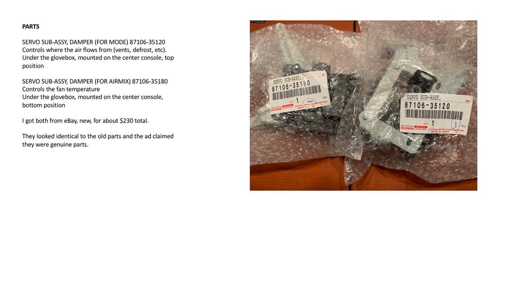

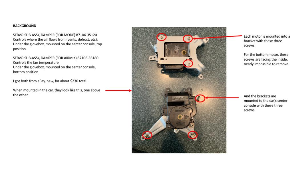

SERVO SUB-ASSY, DAMPER (FOR MODE) 87106-35120​
Controls where the air flows from (vents, defrost, etc).​

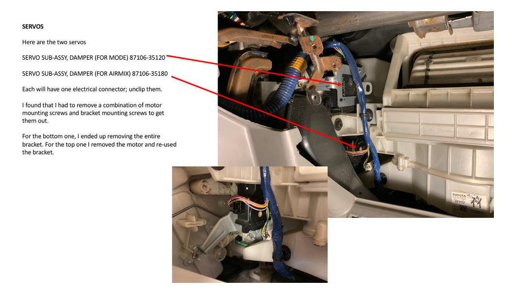

Under the glovebox, mounted on the center console, top position​
SERVO SUB-ASSY, DAMPER (FOR AIRMIX) 87106-35180​
Controls the fan temperature​
Under the glovebox, mounted on the center console, bottom position
Update: Post #12 offers a tip about accessing some of the screws for easier removal of servo. Posts #41 and 42 have pictures for drilling a hole to access the difficult screw.
continued in next post...

It could be the servo. I had the same issue last year. That buzzing was annoying as hell. My problem was with the servo for mode (the one that changes which vents the air comes out). The servo is located to the left of the blower motor above another servo. Since it's easy to do, I recommend removing the glove box and the secret compartment to expose everything and then crank the 4R. This might help you diagnose the problem better. You can watch the servos work while putting them through their paces.
I used a T-handle screwdriver to access the screw in question. It took some patience but it can be done. Same thing with the install...patience.

I've changed out pretty much all of my servos, and one is going out again. I can't remember which of the two to the left of the glove box I was changing out, but there was one screw that was impossible to get to. Rather than remove a bunch of stuff, I drilled a hole through the slot where the cabin air filter sits so I could get a screwdriver on the screw. I then used a $10 ebay borescope connected to my cell phone to watch for when the screwdriver was seated. I taped the screw to the screwdriver for the reinstall.

Just replaced both left hand side servos today - huge thanks to the OP for this thread. By FAR the best piece of advice was this:
The bottom right screw for the upper servo, and the upper right screw for the bottom servo, are right next to each other and inaccessible. I think typically the vast majority of the time needed for this project is on these two screws. Drilling a hole in the side of the box on the left, just above the fan, gives perfect access to these two screws. Magnetizing the screwdriver with a magnet makes putting them back in a breeze. A little Gorilla tape sealed the hole I drilled. I completed this entire project in less than two hours. Works perfectly now - big thanks to everyone who contributed.
