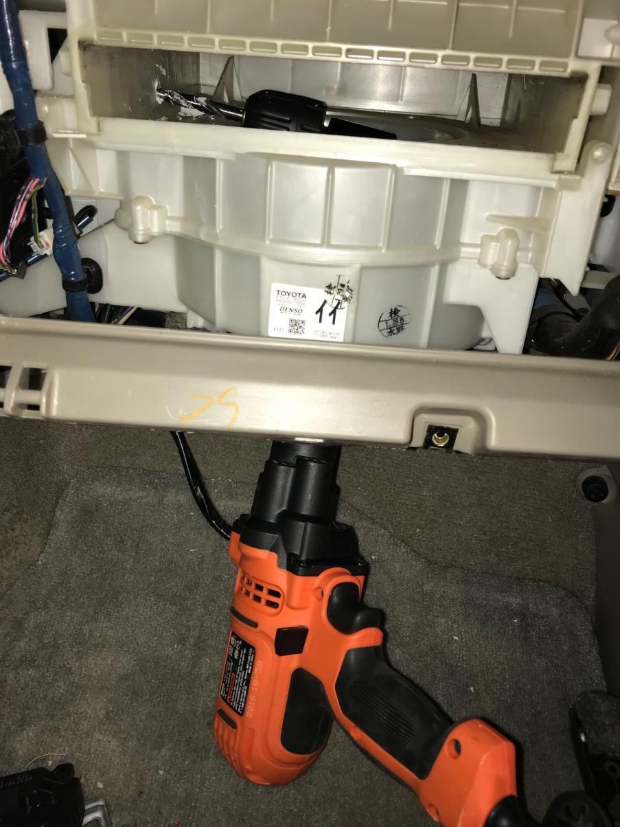

Alright so myself and [MENTION=91393]papabeach[/MENTION] followed this thread yesterday and installed my new servos. Here are some thoughts/recommendations:
-Bought both pieces off ebay for a total of $236 shipped
-Test the two new ones before you go through the hassle of removing the old ones and installing the new ones
-Drilling a hole makes accessing the one screw 1000x easier
-The angle is awkward, so we had to drill in 3" on the side of the air filter cabin to access the screw
-Do NOT strip that screw, it will make your life miserable
-When you put the lower servo in first, make sure you go ahead and put the screw in the slot and line that one up first, it will make remounting the assembly much easier

The original post and this thread are awesome and were key to success with this repair. I signed up to the forum just so I could add my two cents regarding replacement of the "air mix servo". I was a little confused by the descriptions of drilling into the side of the air box. Since I did my repair, but prior to this post, someone else posted pictures of the air box. A picture really is worth a thousand words!
I would just add that the 8 Pc Right Angle Screwdriver Set by Pittsburgh from Harbor Freight made removing and replacing the bottom two screws fairly easy. I also purchased a 90 degree angle drill attachment from Harbor Freight (about $30, item #69337 3/8" Angle Drill Attachment with Keyless Chuck) to help with the drilling.
Two tips: 1) Unclip the wiring from the blower fan and unscrew the three bolts holding the fan in place to access from below. 2) Set the air inflow on the dash to recirculate to slide the accordion door open vertically to see what you're doing.
I drilled further back in the box to provide a straight shot to that top screw which is not visible. I used about a 10" long Phillips screwdriver (#2 I think) and, once it felt seated in the screw, applied pressure to keep it from stripping the screw. As suggested by someone else, I did not replace that top screw. If I need to replace it later, I'll have to either find a long magnetic tip screwdriver or maybe use some light glue to hold the screw to the screwdriver while I get the screw positioned. Covered the hole in the air box with duct tape on both sides.
