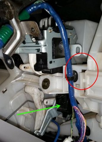

I have a 2003 Limited and don't get heat on the passenger side.
Am I correct in my understanding that IF this is servo related (not heater core related) this would be the "lower" servo on the passenger side next to the center console?
(green arrow in photo - not my photo)
... And that part number is 87106-35140 (replaced by 87106-35180)
... and that this is pretty easy to swap out?
