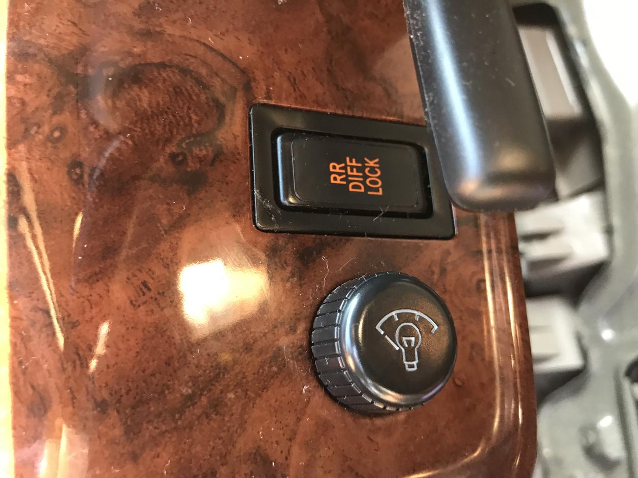

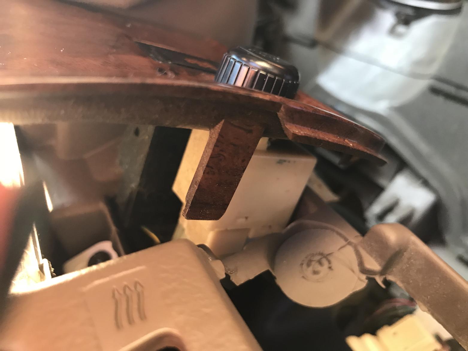

How do I unplug these? I don’t feel the tabs to push to release.
The dash light dimmer knob pulls off to expose a slim nut that holds the potentiometer, just loosen and remove that with a wrench or pliers. There should be a disconnect for the locker switch. With these off, the section of dash trim should pry off, assuming all other 10mm/philips bolts are removed. If you simply disconnect the dimmer knob switch in the back, you won't be able to test your led's at it's part of the same circuit.

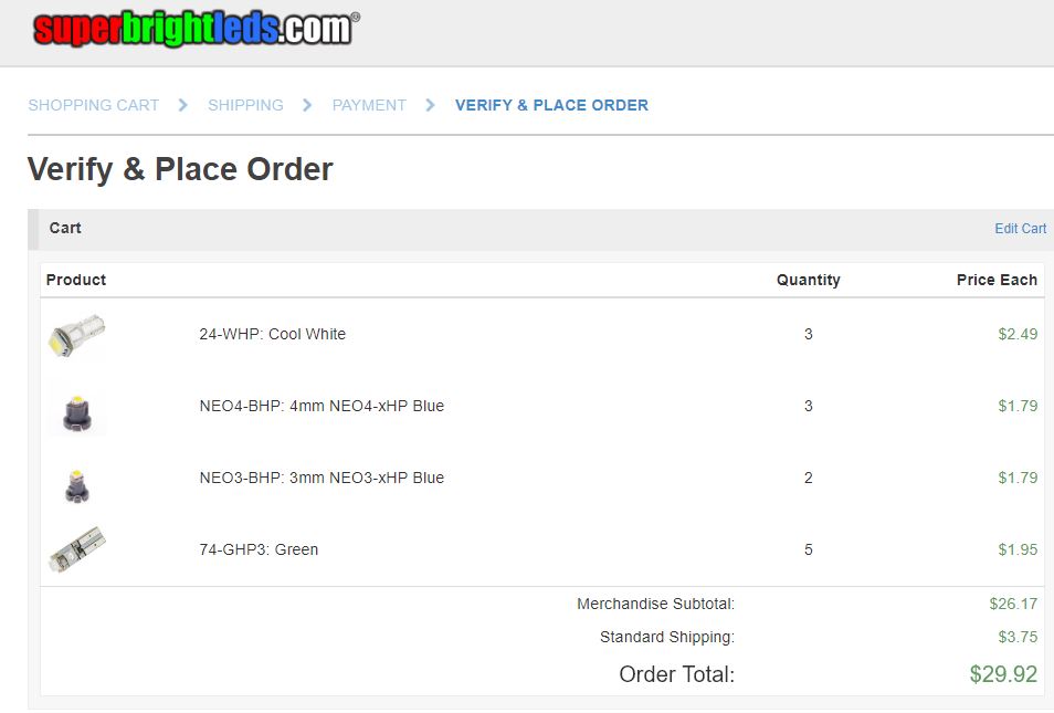

Before I order, can someone confirm this is all good for my 2001 Limited?
OR do I only need 2 x Neo Wedge B (10mm/4mm) --> NEO4BHP 4mm since I have an auto A/C unit?

^^ were those the correct bulbs? I'm also about to order some for an 01 limited, auto a/c
They're the right ones but you only need 2 of the 4mm. Also, the 3mm from superbrightleds are a little loose in the socket so you may have to lift up the wire tails on the base for better contact against the circuit board traces. Then epoxy them in
Can you suggest better 3mm that you used from maybe other sites that don't require such adjusting?
I haven't ordered yet...just waiting on some more feedback from anyone that did these recently.
