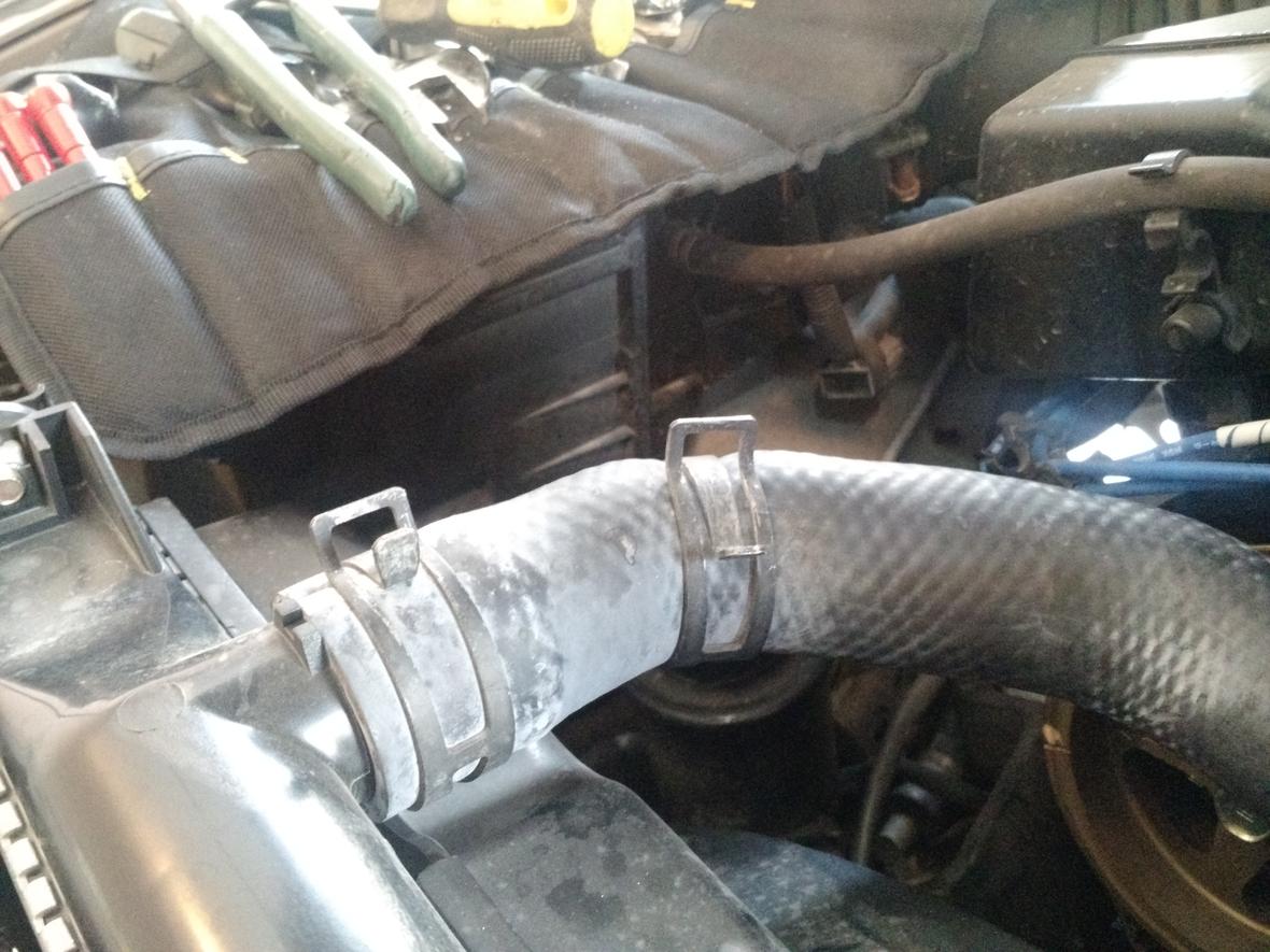

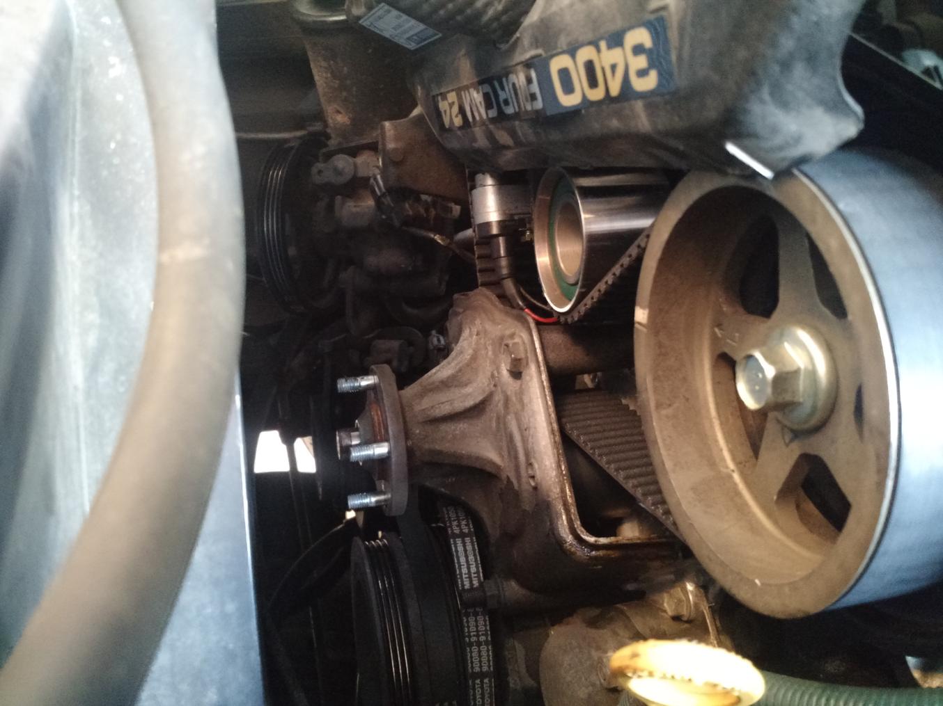

Hi all. I had to replace this in my 1998. Did it last week - ordered the Aisin replacement off Amazon. Currently living in Mexico with limited tools and really didn't want to drain the coolant. I was able to flip the idler cover after sliding the constant tension clamp toward the radiator. Took me 30 minutes at a slow pace and no coolant drained. Pics attached.

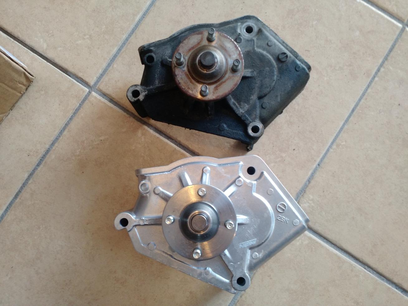

Would be interested to see pictures for anyone who might have attempted to disassemble this part to service just the bearings. From the looks of it, this does not appear to be a serviceable part using standard bearings, even if you did have a press.
I pressed off the flange today and this is what's under it. I looks like the bearings and shaft assembly were installed and then the aluminum was rolled over to hold them in place.

My fan bracket bearing was noisy when taking it off for a timing belt change and I attempted to disassemble it to see if I could replace just the bearings.
The fan bracket bearings are NOT replaceable!
As has been mentioned previously a lip of the bracket breaks off when pressing out the bearing and rod. When attempting to press the rod out of the bearings the assembly explodes due to the way the ball bearings on one side ride in a channel in both the rod side and outside bearing race. Luckily due to the sketchy nature of what I was attempting, I was shielded behind a makeshift blast shield when the outer race let go. The other side has needle bearings it looks like.
A new Aisin fan bracket from amazon is now on the way.
