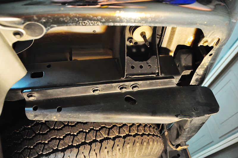

Otherwise, there were no structural issues or hidden damage underneath. The trailer hitch took the bulk of the hit, but the 8 large bolts attaching it to the frame showed no sign of movement whatsoever.

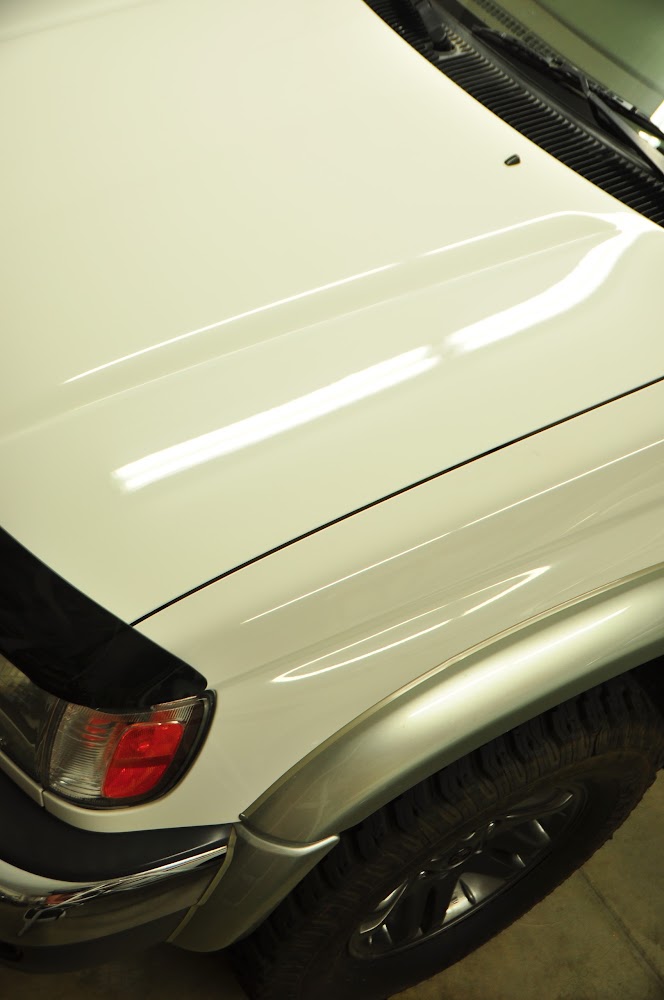

While it was in the booth, I had the shop respray the hood. It had some blemishes since the day I bought it in 2005.
