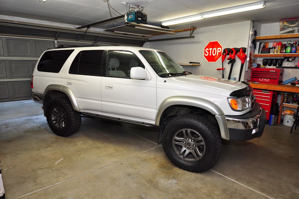

For the past couple of years I have had a boost gauge and wideband gauge hanging out in the glovebox while I decided where to put them in my interior. I ruled out pillar pods just to keep the stealth look going, and I have realized that the boost gauge just isn't something I need. I reads 7 psi at sea level and less as I climb in elevation, and there isn't much reason to look at it.
The wideband, however, is a really useful tuning tool, and I do glance at it on occasion to make sure the engine is holding its tune (it does). I decided to mount it in the open space next to the accessory outlets. It goes black when it's turned off, so it is not noticeable when the truck is parked.
I have the URD 7th injector kit with the upgraded fuel pump, so the engine is 100% ready for a smaller pulley and more boost, but I keep telling myself "leave it be, it has enough power." But I'd really like to see what an extra couple of pounds of boost does to this thing. Hmm...
