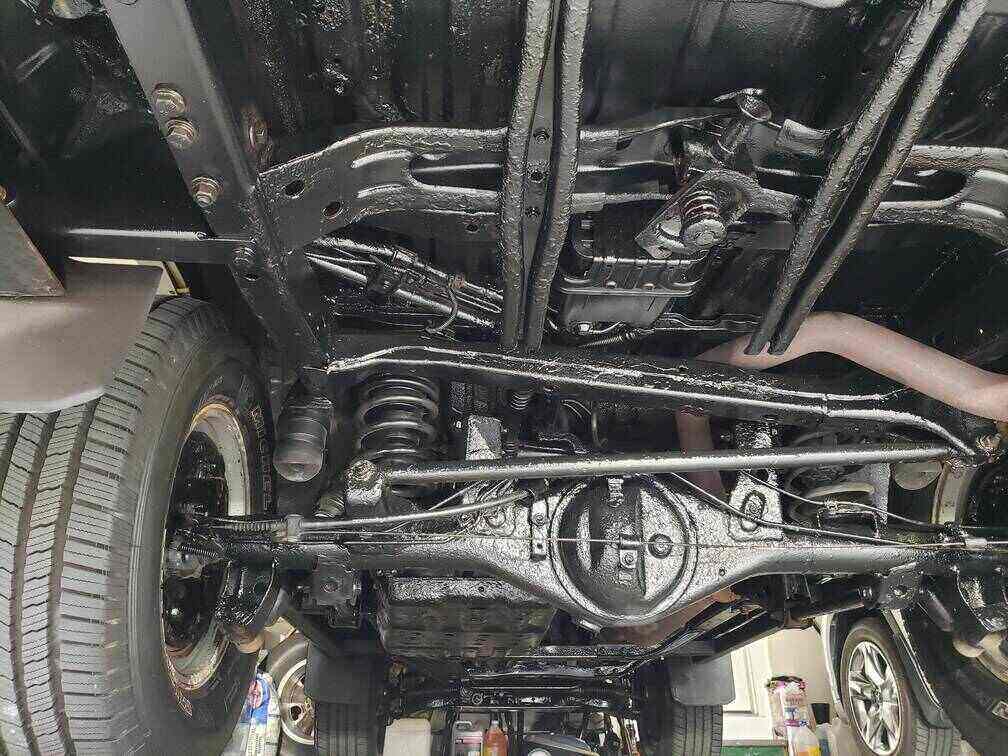

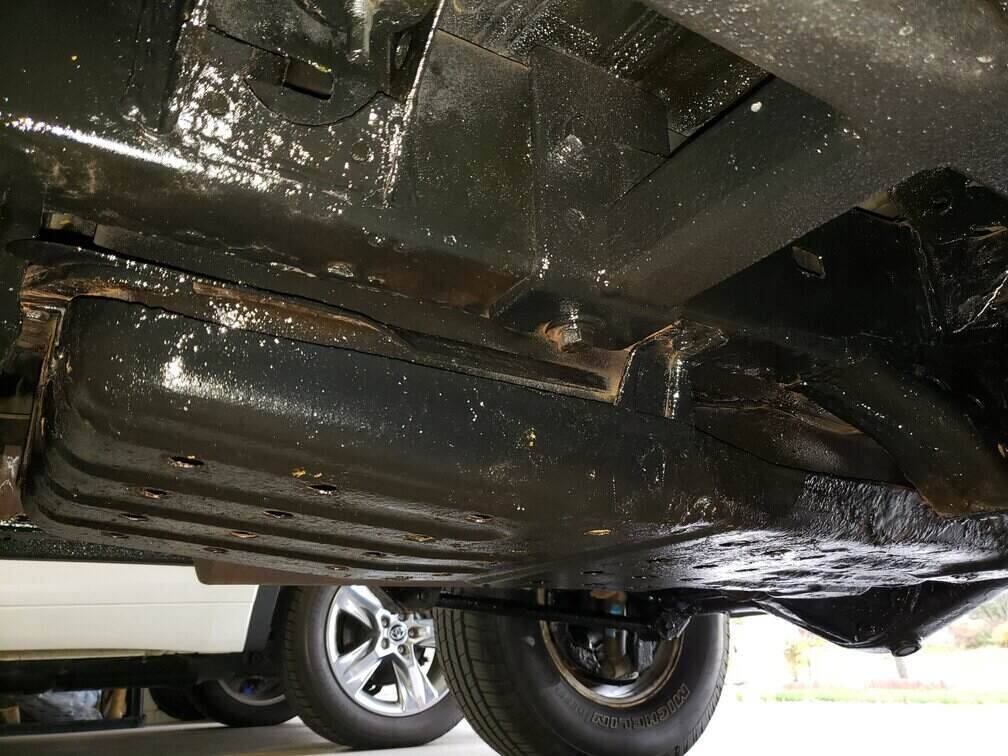

Haven't bought it but will now and let y'all know. I'm getting mine rustproofed with POR15 then Fluid film the week of October 21st. I'll ask them to take some nice pics before they take it down from the hoist.
The plugs I bought from ebay didn't work. It was so tight I couldn't plug the circle holes lol.
Anyways here's some after pics I took after driving it home after the motorcity auto spa place did a wonderful job detailing my car full interior and exterior, I provided them a gallon of fluid film, angle grinder with wire brush cups, fluid film gallon kit.
They did the underbody detail and painted it POR15, then sprayed it all with fluid film after. Ready for the winter!!!
They are supposed to text me after pics while it was up in the hoist so I'll post better ones once I receive them.
