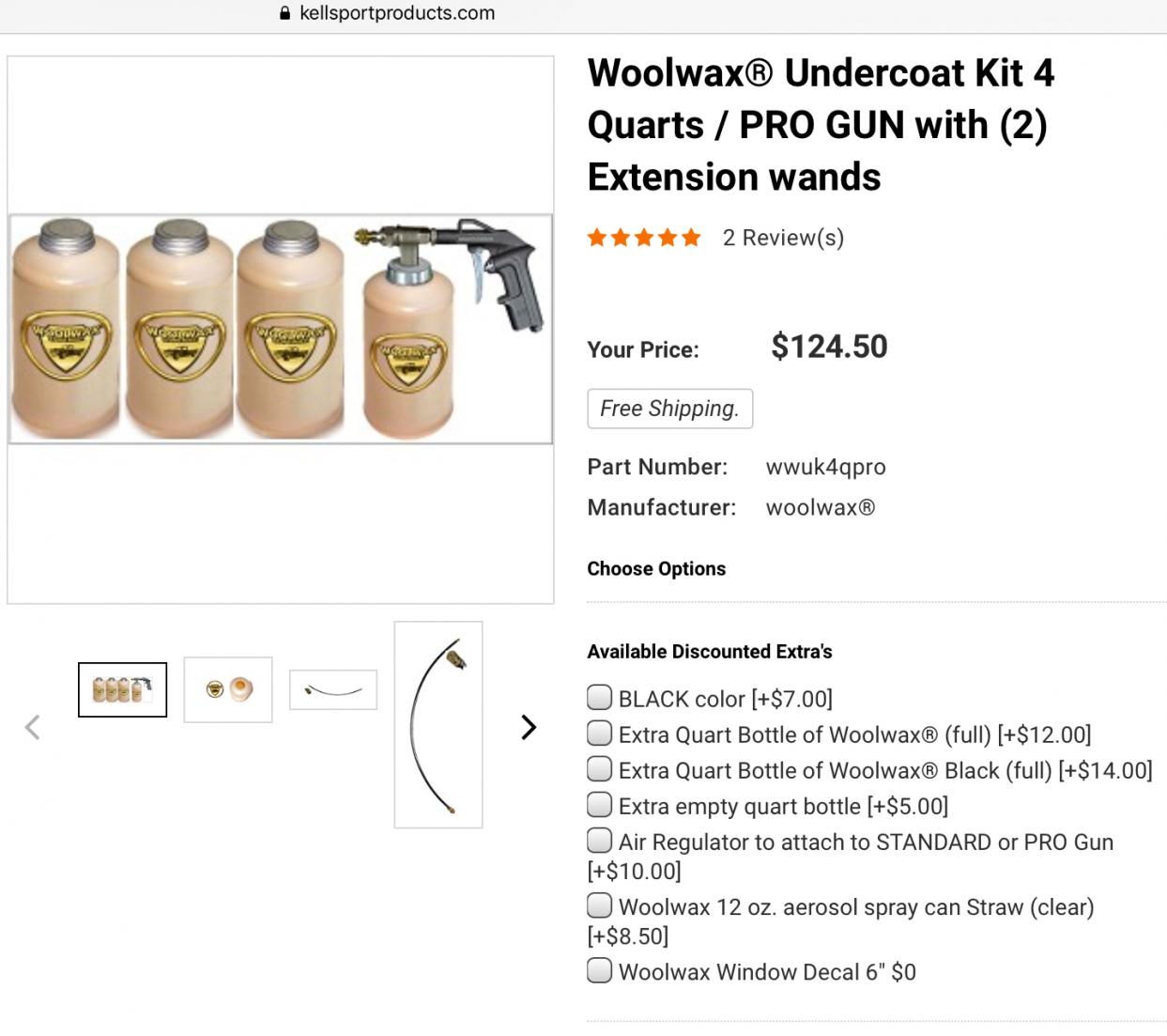

Life in the northeast, the battle against rust continues........placed an order for this Pro Kit yesterday.
After lots of research decided to give Woolmax a try. Also picked up a gallon of Fluid Film but will try out the Woolmax this season.
After speaking with people who have used both they switched to the Woolmax as a bit thicker so less overspray and they thought it held up through the winter a bit better than FF.
Both seem like great products and I suspect either will help keep the rust at bay.
If anyone thinking to buy this stuff skip Amazon and go directly to Kellsport Products website as priced lower and great service.
