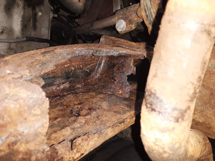

This is a typical 1998 frame from western Pennsylvania. When nothing has been done to it. Don't let this happen to your rig. This is my Tetanus 2 and you can see how the rest of the 4 runner looks from my garage. I save the 3rd gen runners from the scrap and parts yards by fixing the frames. It's why I have so many. ;) My point is watch your frames closely if your in the rust belt. As I can fix this and make it as good as new. However, you can prevent this from happening by protecting your frames with all the methods mention in this thread. :) 20190823_210841.jpg

The criticism I have (and this is coming from automotive restoration, not truck frame restoration, mind you) is that in my experience, POR-15 is typically used on things that are already rusty/rusting, as a stop-gap measure. Things of that sort WILL need rust amendment/patching in the future (unless they are disposable - the stuff I work on is not, whereas truck frames very well may be.) When that time comes, POR-15 makes for a LOT more work to prep & repair. So much so, that I no longer do rust remediation on a car that has it.
This is a typical 1998 frame from western Pennsylvania. When nothing has been done to it. Don't let this happen to your rig. This is my Tetanus 2 and you can see how the rest of the 4 runner looks from my garage. I save the 3rd gen runners from the scrap and parts yards by fixing the frames. It's why I have so many. ;) My point is watch your frames closely if your in the rust belt. As I can fix this and make it as good as new. However, you can prevent this from happening by protecting your frames with all the methods mention in this thread. :)View attachment 344868
Sent from my SM-J337V using Tapatalk
If rust is occurring on the inside of the frame, POR-15 on the outside is doing nothing in terms of protection (since frames rust from the inside out), and I'm dubious about the possibility of properly prepping and coating the inside with it. I think Fluid Film or similar multi-application products (following a good cleaning & rust converter) are a much better option, personally.

You can criticize POR 15 /KB seal all you wish as I stated before everyone is entitled to their opinion. :D
I don't recall ever stating that POR-15 /KB Seal Paint was steel rot solution. As I hope everyone understands paint cant fix rot out. However, that should definitely be mentioned it is not.
Also all epoxy like JB Weld etc should never be used as frame repair either { I found that on my Tetanus 1 before I plated its frame.}
However, these are just my opinions. Folks can criticize all they wish. Just don't be surprised for me come back with rebuttals. :heh:
I Personally, have my 2001 sport 4 Runner chassis done in POR15/KB Seal after I completed repairs on its frame.
I personally, have had good results with these products.
It also seems some others have as well.
I suggest that the plating should be done from the inside of the frames (Brillos Builds). As they rust from the inside out.
I suggest folks cut the bottom of the frame out to plate their frames from the Inside to repair frame damage do to rust as my personal opinion how to repair rusted frames. As doing it that way is not a stop gap method and also a permanent frame repair solution.
Hopefully, this will clear up any issues on this matter. ;-)
After confirming no rust penetration or compromised areas of metal on my frame and removing any areas that have flaking/scaling rust, I’m pretty comfortable at this point coating the exterior of the frame with POR-15 and then applying Fluid Film to all interior & exterior surfaces.
Thanks to everyone for their comments.
Anybody residing in an area of the country that has to deal with salted winter roadways understands some form of treatment to the frame & undercarriage is essential and not optional.......unfortunately!!!
